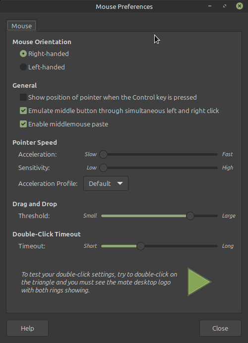

When the mdi-button is doubleclicked accidentally or just clicked multiple times in a short period,
the mdi command is executed , mostly uwanted, multiple times. Is it possible to lock the button for
0.5 second or an adjustable value?

Should be easier to set the "double click" speed for the mouse in the mouse settings, from Linux settings.
This is from Mint, but should be similar on XFCE.

Thanks for reply. I was testing with a value of 200 instead 400 default.  Then i recognized the mdi commands are qeued, so there is no escape from executing every button press. Now i try something with a normal pushbutton and use the pythonmodul. creating a timestamp on each button press and get the difference, only execute the command if result is >=7. I am still testing

I just updated the code so if a MDI command is running the MDI button will not execute again.
