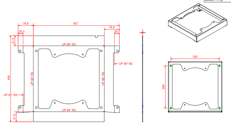

I don't know much either. Here is a part I folded a lot in batches of 20.
The press brake had the knife and lower V block defined in the commercial control. First I numbered each bend on the paper drawing (6 in total) in the order I wanted to do them
Where a flange had already been folded, I would manually deduct the width of the material (2 mm) for the back gauge
Then I built the bend list as you say bend number, angle, length
From memory, there was a calibration screen that set the angle and it was set to under bend just a little but so we had some adjustment on the first part.
Ideally, the operator would not need to know the axis positions and instead you would calculate that from known maths.
Over time, I tweaked the dimensions and bends to get as perfect as I could and the job was saved in the control for next time. Good luck

Fold order: top, ,bottom, left tab, left, right tab, right.
