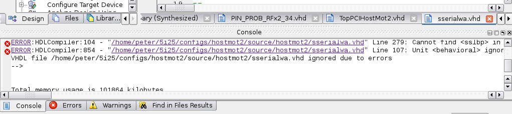

When I try it myself I get from ISE 2 Error. But i change nothing! Whats wrong?
Version 14.7
Version 14.7

Not sure why you have that error
I just tried compiling from the sources and didn't find an issue
are you using the fivei25.xise project file and the latest hostmot2.zip?
MD5 (hostmot2.zip) = 537d9e74c60b1d0864163f0b75eab74d

the error is that the files cannot be found

Actually only the hostmot2.zip file needs to be unzipped
the other zip files:
etherhm2.zip
resmod.zip
sslbp.zip
twiddler.zip
serhm2.zip
ssremote.zip
Are all sources for machine language code that goes in various processor ROM VHDL files
They are provided for reference but are not needed (or usable) by ISE
etherhm2.zip
resmod.zip
sslbp.zip
twiddler.zip
serhm2.zip
ssremote.zip

Ok i try it with the actually files.

Surprise ! It works!
Many thanks for your help.
