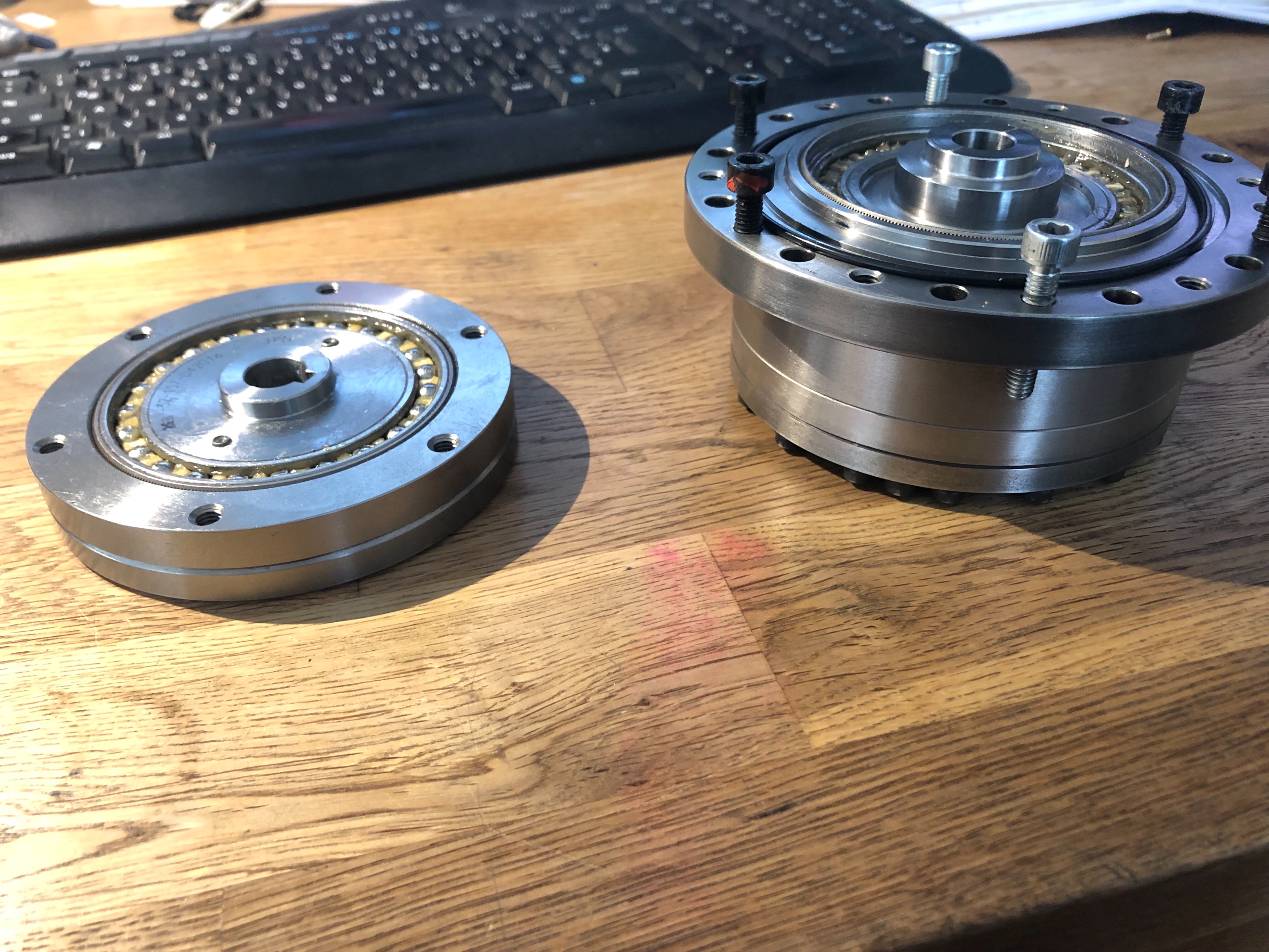

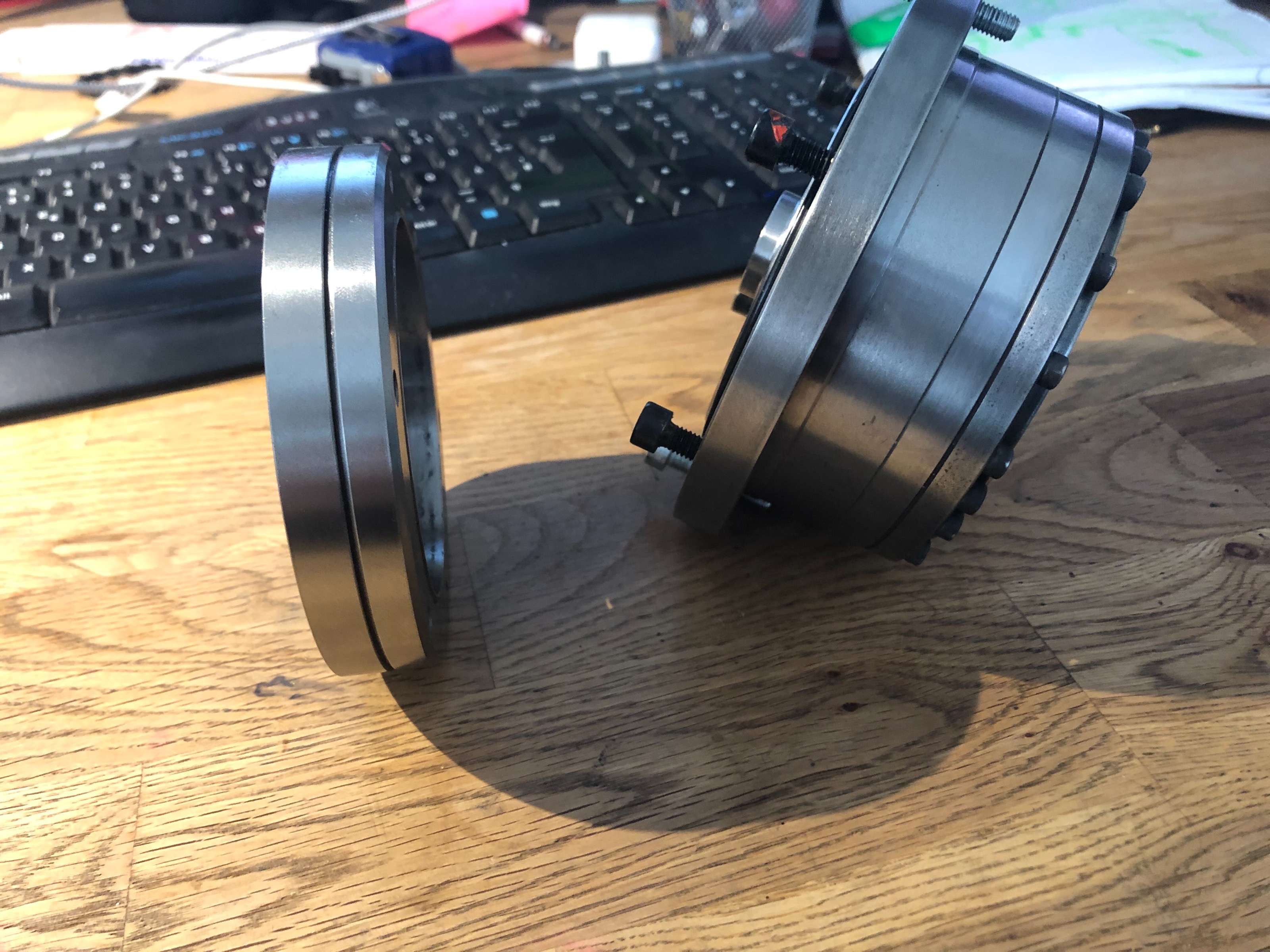

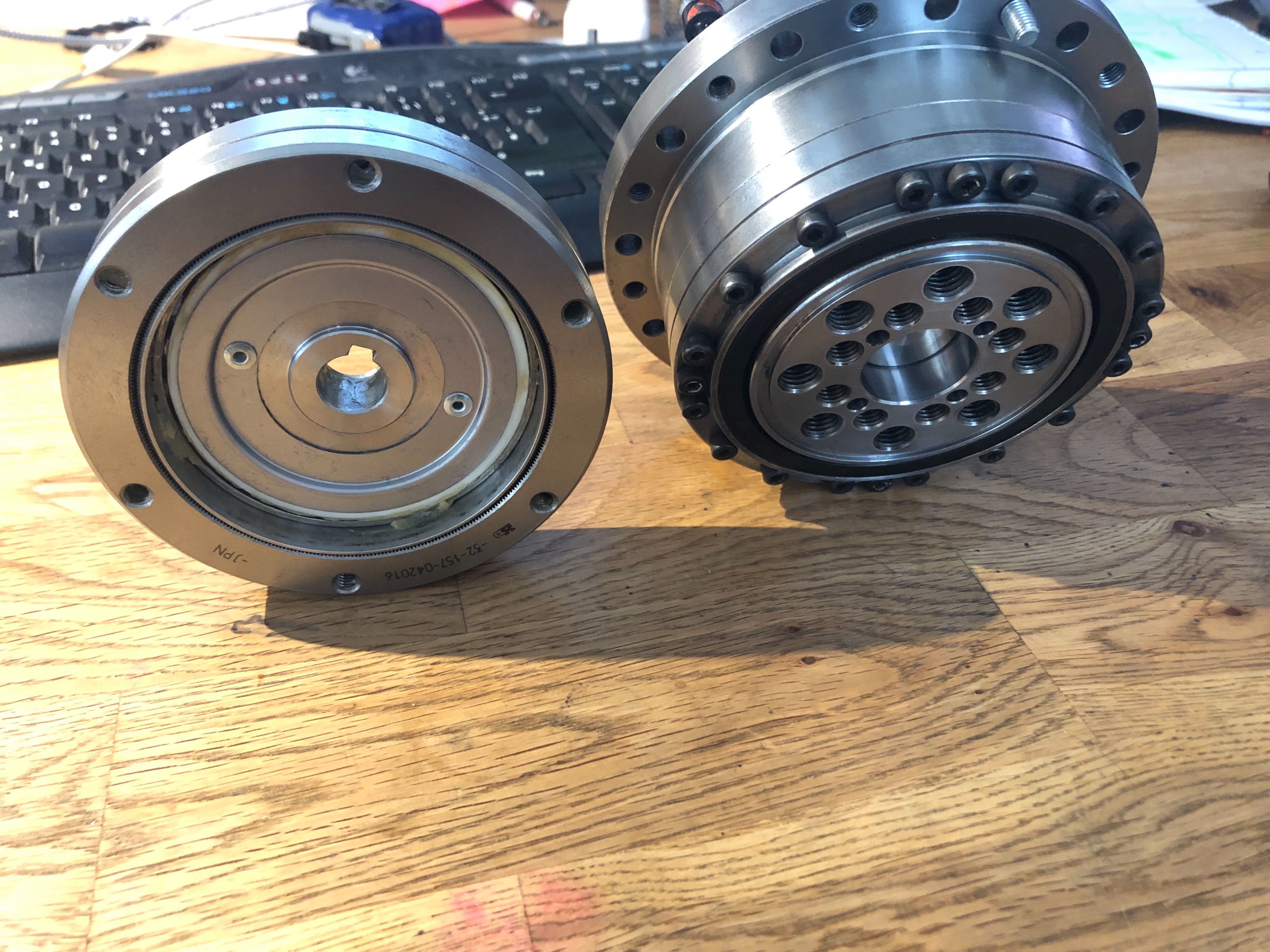

Yes the C FHA25 eats up around 180mm Z travel so it can be swung. The versions with a motor break would consume another 20mm. My A FHA32 does have a break, the C FHA25 does not.
An alternative design that requires somewhat less headroom is the one often seen on Chinese 4/5th axis with a trunnion table where the C axis motor is placed on the opposite side of the A axis and drives the C axis with a belt. I think this would work well with a standard harmonic drive as C Axis driven by that belt. Any backlash caused by the belt would be greatly reduced by the HD reduction ratio.
I do have a standard (HFUC32 without motor, without through-hole) HD and considered that design as well, but due to the overall diameter of the HD, added to the need for coupling it with the belt - additional shaft on bearings with pulley, the actual height reduction is not that significant - the FHA are already quite compact.
There are some HD which are extremely compact, I also bothered to get a 32 size one in the hope I could use if for the C axis, but those only provide rotational reduction without dealing with any axial or radial load ....
All in all, HD gear, radial and axial load bearings, servo motor + encoder, I find the FHA are pretty compact as they are.

Harmonic drives are nice and have almost no backlash, but really are expensive. Then there are Hypocycloidal gears, which may be more rigid but also cheaper and also have almost no backlash (afaik)

I read or heard somewhere that Hypocycloidal gears are not that resistant to crashes ... no idea, but it turned me off a bit. For a long time I considered Hypocycloidal gears as well, one advantage is that they are capable of faster rotation. For example the Mazak Intergrex uses a hypocycloidal gear on the spindle - see .
Now, I could never find a Hypocycloidal on eBay for a good price and in a good format to make a 4/5 axis - can you?
HDs appear now and again on eBay/Ebaykleinanzeige for a good price. It takes months, even years to get a break - I got lucky a few times, twice for FHAs and on top of that of an ideal size for my mill work envelope.
Then of course there is the servo drive issue if one has to also get a HD configured Drive - I didn’t.
But yes it’s a long shot by any measure.
