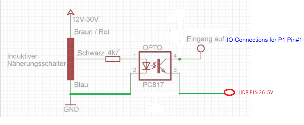

30 May 2021 06:29 #210669
by Dolfein
Induktiv nährungschlter was created by Dolfein

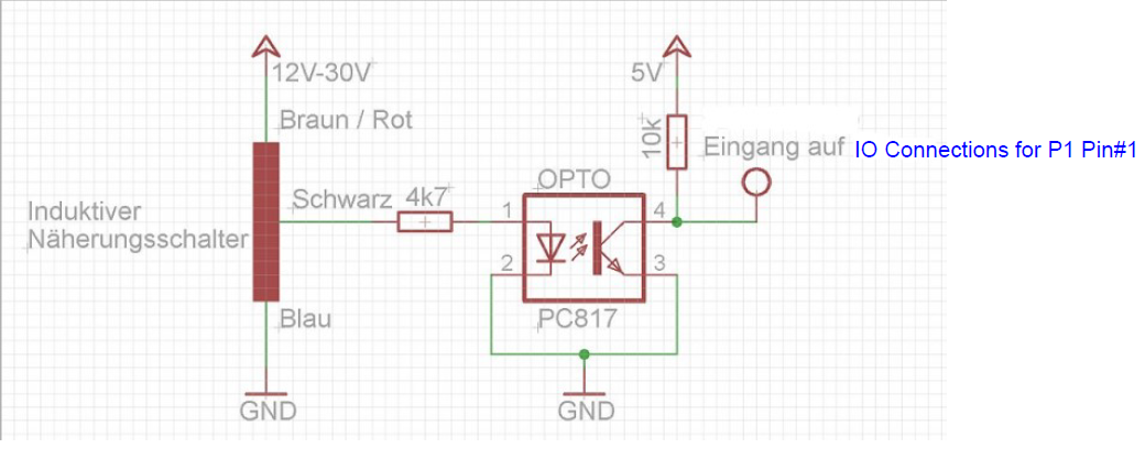

Replied by PCW on topic Induktiv nährungschlter
Also with a 7I92 you don't need the 10K pull-up on the OPTO since
all I/O pins have built-in 4.7K pull-ups.

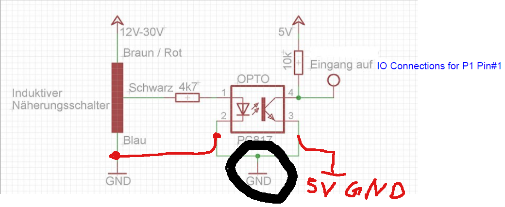

The opto-coupler transistor emitter should be grounded
so you don't need 5V for that circuit
