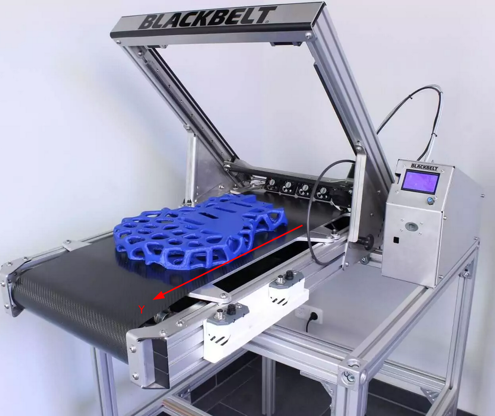

Hallo zusammen,
meine Y Achse ist unendlich lang, ich hatte irgendwo mal was gelesen was man dann beim MIN_LIMIT und MAX_LIMIT eintragen soll, doch ich finde es nicht mehr
Weis jemand, wo ich das wieder nachlesen kann? Oder kann mir sagen, was ich da eintrage.
ps. Die Achse hat einen Home Schalter jedoch keine Endschalter
Gruß Mücke
Damit man sich das ungefähr vorstellen kann. Habe ich ein Bild im Internet gefunden, das Prinzip gut darstellt.
Gruß Mücke

Ich habe es wiedergefunden.

Version 2.7??? Please ensure you read the documents for the version of Linuxcnc you are using as the 2.7 documents probably no longer apply to 2.8 and 2.9 as there are many changes with homing, axes and joints and others.

You're right, I was so glad that I found the info again that I didn't pay attention to the version.
Fortunately, nothing seems to have changed in this area.
The documentation 2.9: linuxcnc.org/docs/2.9/html/config/ini-config.html
[Zitat]
[Zitat]
MIN_LIMIT = -1000 - The minimum limit (soft limit) for axis motion, in machine units. When this limit is exceeded, the controller aborts axis motion. The axis must be homed before MIN_LIMIT is in force. For a rotary axis (A,B,C typ) with unlimited rotation having no [code]MIN_LIMIT for that axis in the [AXIS_<letter> section a value of -1e99 is used.
