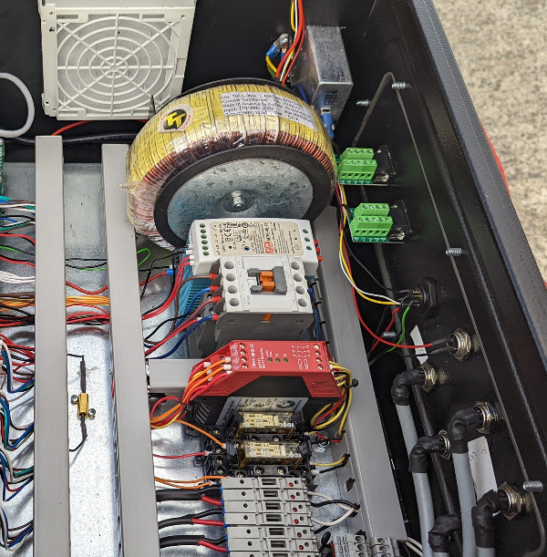

Actually re-reaading your first post, you have a safety relay. Here is mine.
The safety circuit is the red relay, the breaker above it and the two force guided relays below it (K3 & K4 in the diagram in the PDF)
A safety relay requires a pulse to latch the machine on (Eg take out of estop).
There are two ways to do this.
One is to use an external momentary switch (which is what I did). In this case, I connected the latch button to an input. I simply did this in HAL
net emc-enable <= lcec.0.3.in-01
net emc-enable => iocontrol.0.emc-enable-in
Linuxcnc is enabled once the hardware latch button is pressed.
The other way to do this is to use
iocontrol.0.user-request-enable
to enable the safety relay (S34 in my diagram)
iocontrol.0.user-request-enable receives a pulse you can see with halscope when the axis orange button is pressed which can be used in place of my eternal latch button. I did play with it this way and went with an external button. I think I just connected an output pin direct to S34.
