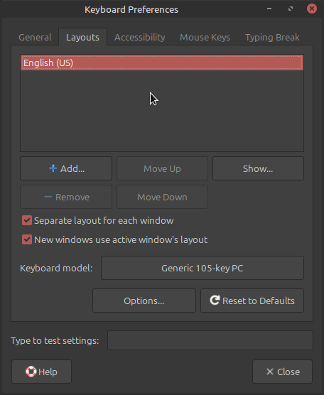

17 Oct 2024 21:47 #312433
Menu>preferences>keyboard>Layouts tab, add
there add "English (US)" layout, a bit lower check if the "keyboard model" is "generic 105 key PC" and change if not, close.
Now there should be a little icon on the lower right side with US or DE in it, click on it and change to US, try jogging with []
@Tchefer,
No, and i can not find it now, will have ask google later and report back.
Replied by tommylight on topic Welche Tasten haben die Achsen?
@Tchefer,
The following user(s) said Thank You: Tchefter
