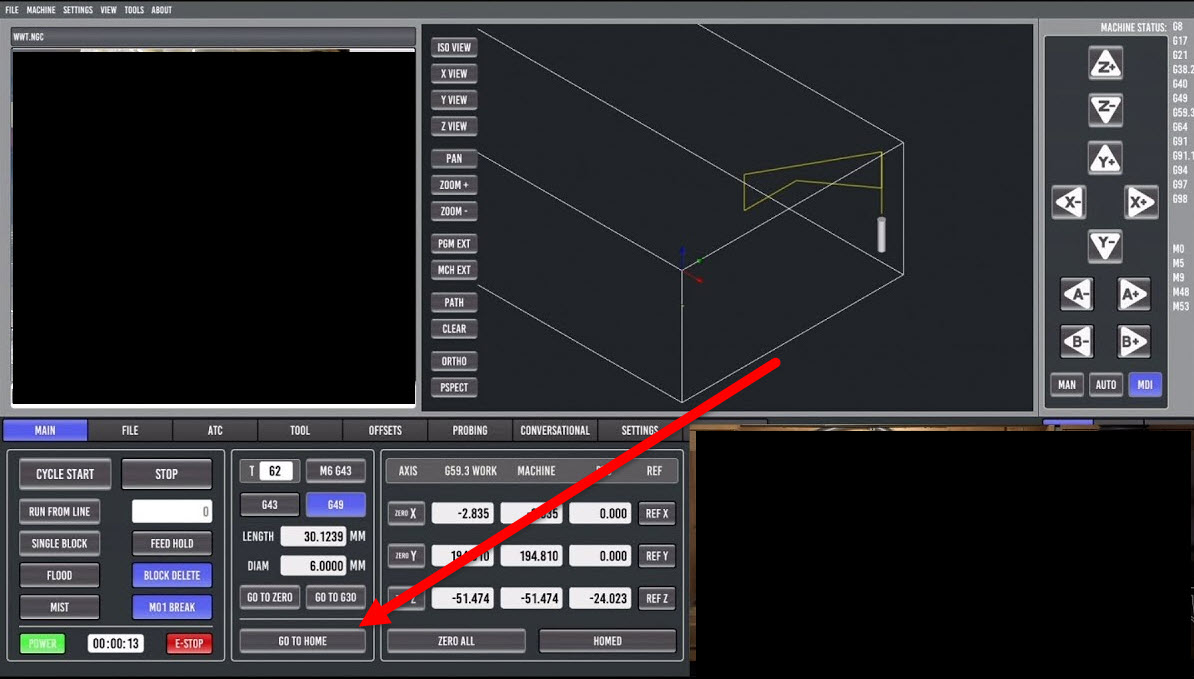

20 Nov 2025 14:54 - 21 Nov 2025 00:24 #338831
by Jensner
Replied by Jensner on topic Aufschaukeln mit JMC iHSS60-36-30-21-38 in Verbindung mit Linear Encodern
Hello,
today I did the steps from tommy`s link.
At the end i played around with the P and FF1.
After arount 50 different tests, slowly the hard errors dissapeared and at the end i found the best working configuration with P=15 and FF1 =1
So I configured this parameter on all 3 Axes and it works.
Only one last problem is the speed for "Go To Home"
Is ther a info where i can find the different settings for all moves?
Jogging Speed is OK and i can change ist via the GUI.
Homing Speed is also OK, but "Go Home" is far to fast.
Best regards
Jens

20 Nov 2025 15:03 #338832
Replied by tommylight on topic Aufschaukeln mit JMC iHSS60-36-30-21-38 in Verbindung mit Linear Encodern
Was ist "go home" ?
A button on the GUI?
Probably by editing that button from G53 to G54 Fxxxx ...

21 Nov 2025 00:00 #338858
by Jensner
Becouse of this speed-problem i had a look at the documantation for the INI.
There are many more questions, but maybe I found some answers.
- In [TRAJ] i lowered the DEFAULT_LINEAR_VELOCITY and MAX_LINEAR_VELOCITY
By the way, at the moment I do not check exactly how there where Velocity and acceleration-variables in TRAJ, AXIS_ and JOINT_
- One more thing i found, was the DEADBAND = 0.0
In the documentation it means that this is the tolerance-variable for the PID if the position is between the tolerance.
So in my config this is 0.0 this should be to less an leads to "Servo Hunting"
