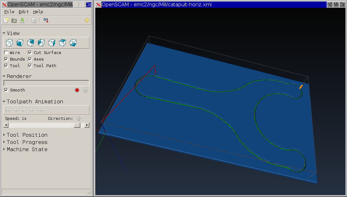

Bonjour à tous.
Il m'arrive parfois de taper du gcode sur un ordi autre que celui sur lequel se trouve linuxcnc, depuis quelques temps, je cherchais un visualisateur de gcode, Et bien voilà, c'est chose faite, en plus, il est léger.
Il s'appel OpenSCAM, vous pouvez vous le procurer là : www.openscam.com/

cart wrote:
I agree, I have it installed and sometimes use it instead of starting a RIP install, just to check the code looks right
This is a recent bit of CAD/CAM generated code to cut a catapult (slingshot to our trans-atlantic cousins) frame from 10mm plate
What it does show however is that incremental cuts are not clearly defined, you have to zoom in a lot to see the individual paths for each cut and not that clear even then.
However a useful tool and worth having

BTW, there's a new version of OpenSCAM out: openscam.org/ Please, tell me what you think.
