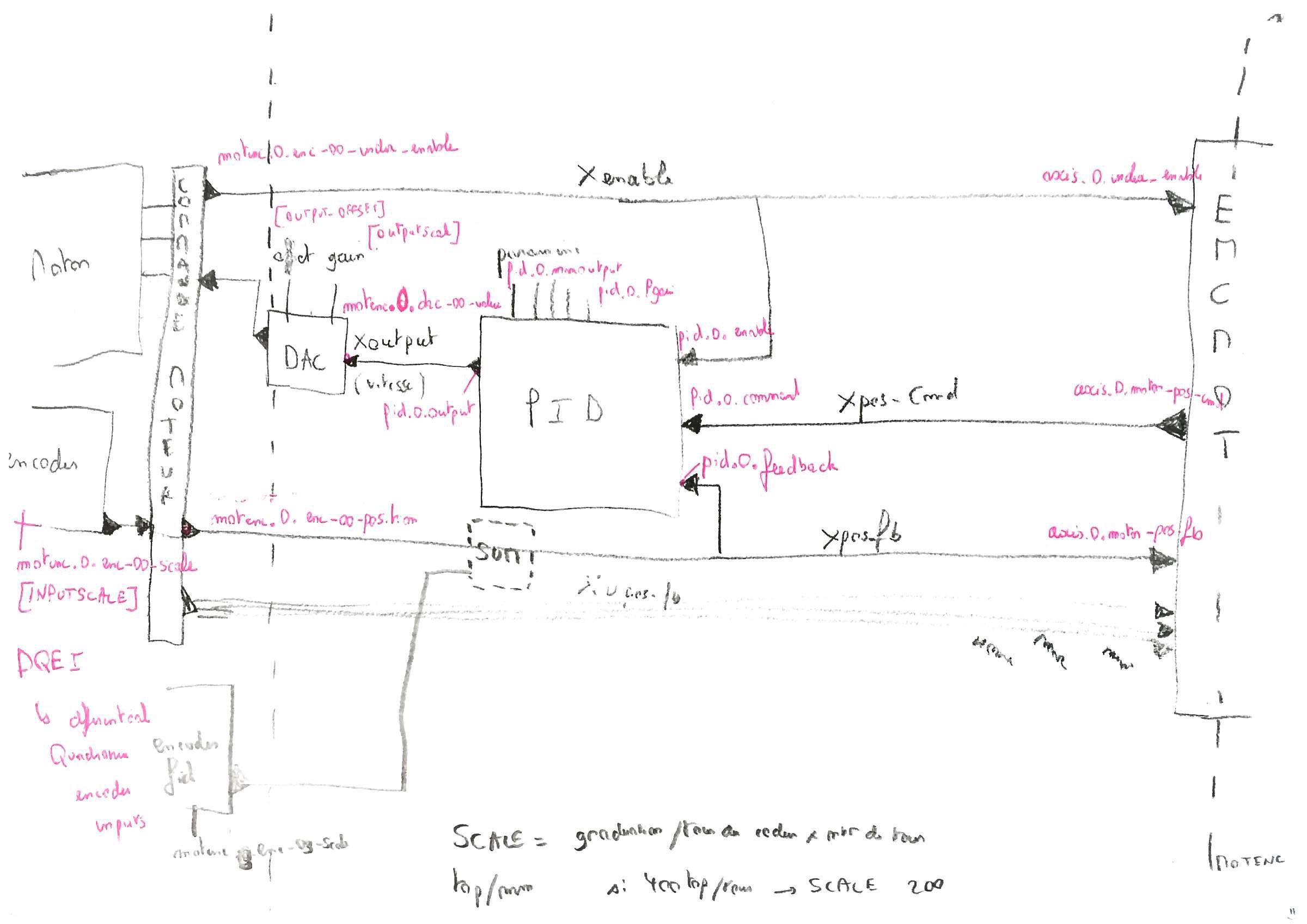

23 Feb 2015 23:22 #56243
by vincentECN
Replied by vincentECN on topic Cinématique avec axes "redondants" (+présentation)
So,
I have modified hal files and ini file for the real machine (after had an overview of the configuration, see "Document Scannable").
There is few modif (to add a disturbance on X), like this :
In INI, only one line in [AXIS] for the scale of new encoder (i can also directly add on hal ?) :
In montenc_motion.hal :
In core servo.hal :
Did i miss something ?
And first, before try to add a real encoder, i want to try with a manual entry on hal, for the real machine. In motenc_motion.hal, instead of "linksp Ufic <= motenc.0.enc-03-position" Can i do like this :
? But i'm wondering, if I define Ufic, for example, by sets Ufix 0.1 (in "show hal configuration"), the machine will think that there is 0.1 mm of displacement at each period ? (so, can escalate quickly) ??
I want to be sure before trying in the next few days. ^^"
Thx for your help !
INPUT_SUM_SCALE = -200
loadrt sum2 count=1
addf sum2.0 servo-thread
linksp Xpos-fb <= motenc.0.enc-00-position
net Xpos-fb sum2.0.in0
net Ufic => sum2.0.in1
setp motenc.0.enc-03-scale [AXIS_0]INPUT_SUM_SCALE
net XUpos-fb sum2.0.out
In core servo.hal :
net XUpos-fb axis.0.motor-pos-fb => pid.0.feedback
newsig Ufic float
sets Ufic 0
Thx for your help !

24 Feb 2015 03:48 #56253
This is a rather old-fashioned way to define nets. You can just use:
etc
No, the addition will only be cumulative if you feed-back the result of the addition to the input.
You can actually run the basic config in a stepper simulation if you want, but I would run it on the actual hardware with the motor shaft disconnected I think.
Replied by andypugh on topic Cinématique avec axes "redondants" (+présentation)
linksp Xpos-fb <= motenc.0.enc-00-position linksp Xpos-fb <= motenc.0.enc-00-position net Xpos-fb sum2.0.in0
net xpos-fb motenc.0.enc-00-position sum2.0.in0
net xdelta motenc.0.enc-03-position sum2.0.in1
etc

24 Feb 2015 21:22 #56269
by vincentECN
Thx for your response. (so i've seen a mistake with two lines in double...)
So, what can i observe in this case ? If the hal is good ?
And when you say "disconnect the motor shaft", it's from the driver card ?

24 Feb 2015 21:37 #56270
No, I mean disconnect the motor from the machine mechanically so that you can't damage the actual metal parts through misconfiguration.
#And when you say "disconnect the motor shaft", it's from the driver card ?
