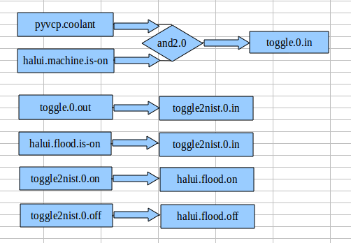

Toggle Flood with One Button was created by BigJohnT
This example shows you how to toggle the flood coolant with a single button. It can be a physical button or a pyvcp button or both if you add and or2 to use either button. In this example I used a pyvcp button.
# Flood Coolant Toggle
net coolant-btn and2.0.in0 <= pyvcp.coolant
net coolant-ok and2.0.in1 <= halui.machine.is-on
net coolant-request toggle.0.in <= and2.0.out
net coolant-toggle toggle2nist.0.in <= toggle.0.out
net coolant-is-on toggle2nist.0.is-on <= halui.flood.is-on
net coolant-on halui.flood.on <= toggle2nist.0.on
net coolant-off halui.flood.off <= toggle2nist.0.off
The image shows the basic connections. It breaks down like this:
If the button is pushed AND the machine is on then input to toggle is on.
When toggle input is on change the output state
When toggle out is on toggle2nist input is on.
When toggle2nist in changes states
If coolant is on output off
If coolant is not on output on

15 Jun 2011 10:12 - 15 Jun 2011 10:54 #10524 by piasdom
Replied by piasdom on topic Re:Toggle Flood with One Button
now dats some good xplaneing.
gonna see if it can use it on my on/off - run/stop pyvcp button.
Great Job ! T'anks !
p.s. edited - your toggle(in file, not pic) are mismatched?

15 Jun 2011 11:00 #10526 by BigJohnT
Replied by BigJohnT on topic Re:Toggle Flood with One Button
What do you mean?
John

15 Jun 2011 11:29 #10529 by piasdom
shouldn't toggle be toggle.0.in and toggle.0.out ?
yours:
net coolant-toggle toggle2nist.0.in <= toggle.1.out

15 Jun 2011 11:31 #10530 by BigJohnT
Yes, that was a good catch on that typo. Sometimes you can't see the forest for the trees... or something like that.
John
