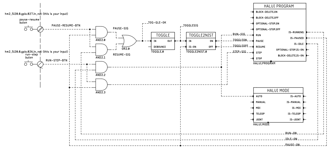

The following is block diagram based on BJT Run/Step Hold/Resume Buttons hal netlist file as shown at the beginning of this discussion.

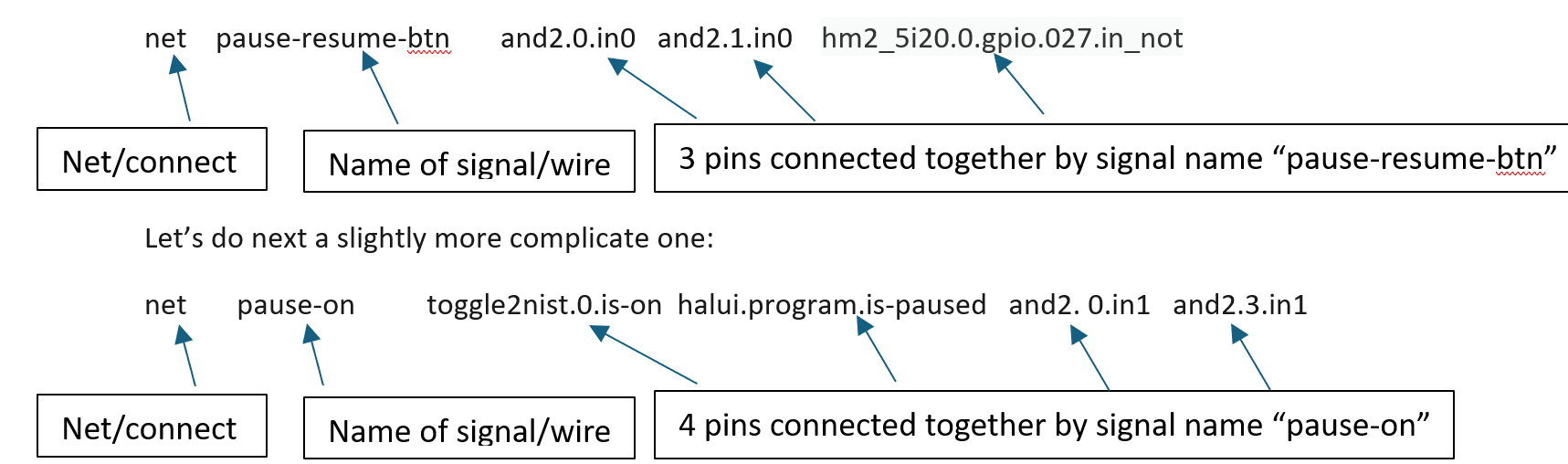

  Now, let’s start little tutorial that show how you can generate hal file from a block diagram:Let’s take the first line of the block diagram and convert it into hal netlisting:
  I let you do the rest as an exercise. Once you get hang of converting block diagrams to hal netlist you will find that it makes creating hal solutions much easier.Now if you would like to automatically generate hal file from block diagram. The one I use is eagle2hal see LinuxCNC wiki or even better use Ed Nisley kicad to hal. softsolder.com/2021/03/25/kicad-to-hal-basic-schematic-symbols/
