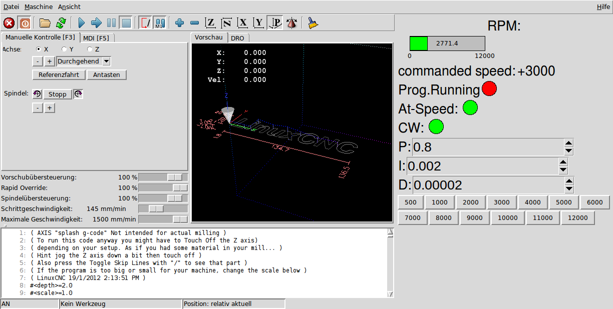

07 Jun 2016 20:19 - 08 Jun 2016 09:16 #75664
by danimal300
Replied by danimal300 on topic hal: lpt spindle quad encoder with pid
Thank you for posting this! I have been trying to incorporate this into my machine, and I was wondering if you could walk me through the operation of your PID algorithm.
I am having problems tuning the speed values and my displayed spindle values jump all over the place, even when I have I and D off. are there other I and D values that need to be turned off to be in true proportional mode? I am talking like 500 - 10,000 jumps when set to 200 RPM.
I know that it has been years since you posted this, but any help that you could provide would be greatly appreciated.
Edit: disregard the jumping around issue, I forgot that I changed the low pass filter value to 1 when I was testing. I have it settled back down pretty well now.

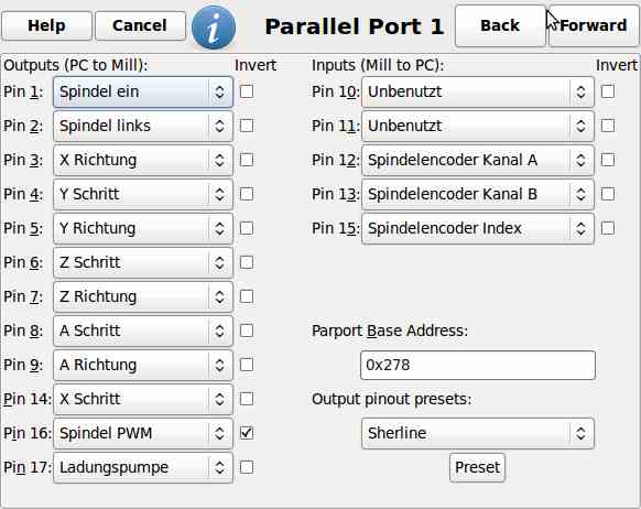

31 Aug 2024 23:59 - 01 Sep 2024 00:01 #309128
by PhilipME
Replied by PhilipME on topic hal: lpt spindle quad encoder with pid
Apology for my simple questionÂ
Spindel ein
and
Spindel links
equivalent English
Spindle on
and
Spindle CCW
then on the parport input pins
spindelencoder kanal A
and spindelencoder index
are
spindle phase A
andÂ
spindle index
Is my understanding correct?
Best regards
Philip
Spindel ein
and
Spindel links
equivalent English
Spindle on
and
Spindle CCW
are
spindle phase A
andÂ
spindle index
Best regards
Philip
Last edit: 01 Sep 2024 00:01 by PhilipME.
- juergen-home
- Posts: 44
- Thank you received: 15
07 Sep 2024 01:46 #309541
by juergen-home
Replied by juergen-home on topic hal: lpt spindle quad encoder with pid
This is correct.
