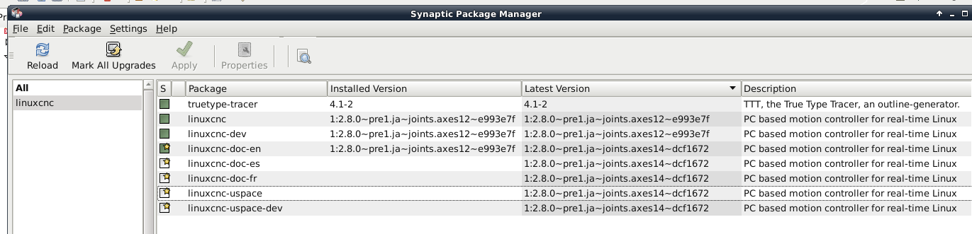

What am I doing wrong here? I added the rt preempt source but I cannot find a linuxcnc joint axes version, see blow:
root@cnc-router:/home/mjohnson# more /etc/apt/sources.list.d/linuxcnc.list
deb buildbot.linuxcnc.org/ wheezy scratch-rtpreempt
deb-src buildbot.linuxcnc.org/ wheezy scratch-rtpreempt
root@cnc-router:/home/mjohnson# apt-get update
root@cnc-router:/home/mjohnson# apt-cache search linuxcnc
linuxcnc-uspace - PC based motion controller for real-time Linux
linuxcnc-doc-en - PC based motion controller for real-time Linux
linuxcnc-uspace-dev - PC based motion controller for real-time Linux
linuxcnc-doc-fr - PC based motion controller for real-time Linux
linuxcnc-doc-es - PC based motion controller for real-time Linux
truetype-tracer - TTT, the True Type Tracer, an outline-generator.
Please advise on how to get the package, and then where I can read docs on how to configure it (or do I just run pncconf?)

25 May 2016 18:31 #75094
I think that's the one. If you look at the extended details in Synaptic:
Replied by andypugh on topic Gantry hal example

Okay, I got JA14 installed. When I launched it the attached error occurred trying to convert my config files.
I then ran pncconf to create a new config from scratch instead, but when I try to click forward button it gives a prompt saying that if I selected tandem axes I must specify a master stepper, however, I do not see where I can do that so I am stuck.
What do I do?
What do I do?
