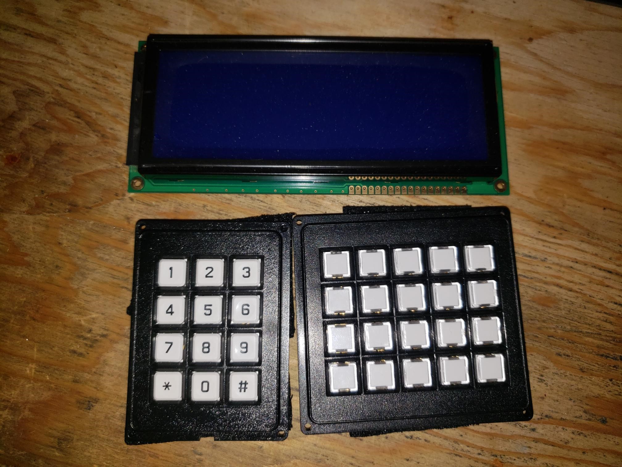

Could you post a pic of your display and mention the display and keyboard you used (and maybe where you got it?)
Thanks.

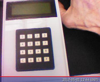

01 May 2017 12:44 #92439
by rotwang
Replied by rotwang on topic Basic Pendant with 7i73
The display is a bog-standard 20x4 LCD, Ebay special from China (I bought a bunch of them a while ago while I could still get black-on-yellow/green, since I hate white-on-blue) and the keyboard out of the scrap box is a 4x4 matrix made by Digitran of Pasadena.
Neither of them is anything special, they just happened to be to hand.
The only identifier on the display is "QC2004A", no makers name or any other brand. Its quite large, the PCB is 4" by 2 1/4" and the actual display area is 3" by 1".
The contrast is fine just left as 7i73 default.
Really, all the smarts are in the 7i73.
I'd be ashamed to show the inside of the box, its just a rat-nest of dupont female-female jumper cables wired straight out of the 7i73 manual.
Cut one end off a straight-thru cat5 cable, connect the ends to TB3 on the 7i76 as per the 7i76 manual, set the 7i73 jumpers for display and keypad and you're up and running slick as goose grease on a china doorknob.
I'd hazard a guess that ANY 20x4 display would work and the worst you'd have to do is fit a contrast adjustment pot instead of using the VEE pin on the 7i73. Likewise the keypad, practically and type, membrane or click-dome switch should work, even discrete pushbuttons.
