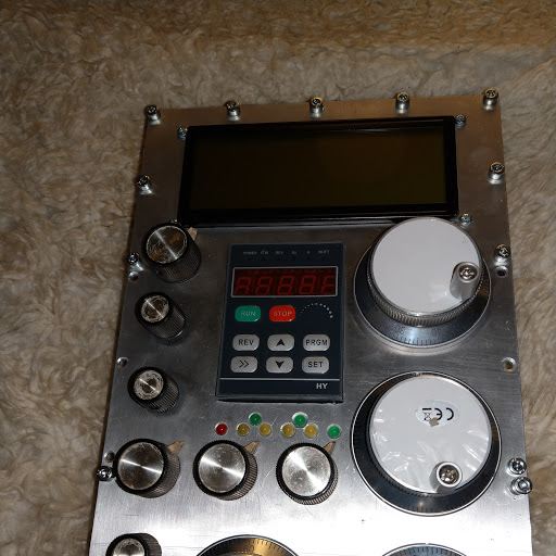

- Mike_Eitel
- Posts: 1051
- Thank you received: 183
10 Mar 2019 03:50 #128214
by Mike_Eitel
Replied by Mike_Eitel on topic Basic Pendant with 7i73
Yes, I integrated the huanyang panel plus MPEG for 4 axes plus analog speed etc.
I was enerved from constant choosing (wrong) axis before moving (the correct)
Have to draw the symbolic and probably try to get them laser printed on aluminium foil.
Mike
Mike
- pl7i92
- Posts: 1872
- Thank you received: 359
10 Mar 2019 04:34 #128218
by pl7i92
Replied by pl7i92 on topic Basic Pendant with 7i73
are the Axis safe in some way as you need to press a second button to move
or as 4 MPG on it is likly to be hazzard to move the pendand
highly risky for me on just taking a look PRO Use only grandpa will kill the mashine
- Mike_Eitel
- Posts: 1051
10 Mar 2019 04:50 #128221
by Mike_Eitel
I'm the only user. And I'm not a believer in hyper-protection against myself.
And i stick with LCNC/Gmoccapy modes model. So no moves in auto.
And when in manual I want them to move.
Small detail: X and Y are always on the same "increment"-factor. And rotative axis A has "degrees" oriented ones. So 4 mpegs have 3 selectors.

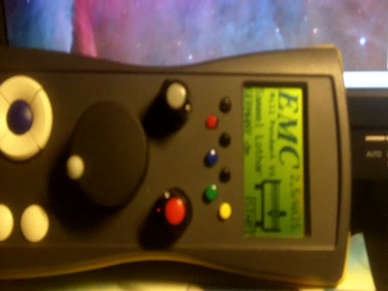

- Posts: 12176
- Thank you received: 4155
10 Mar 2019 06:16 - 10 Mar 2019 06:17 #128224
Replied by rodw on topic Basic Pendant with 7i73
Just an idea. If you do have a seperate button that needs to be held down to use a MPG, you might be able to configure that to select teleop mode as you press it. This has been a godsend to me. I can grab the pendant and jog from anywhere even if I'm a few metres from the console. In gmoccappy, it takes you straight to the jog tab and away you go.
# --- PENDANT SELECT JOG MODE (Yellow Button)---
net pendant-jog <= hm2_7i76e.0.7i76.0.0.input-30
net pendant-jog => halui.mode.teleop
Last edit: 10 Mar 2019 06:17 by rodw.
