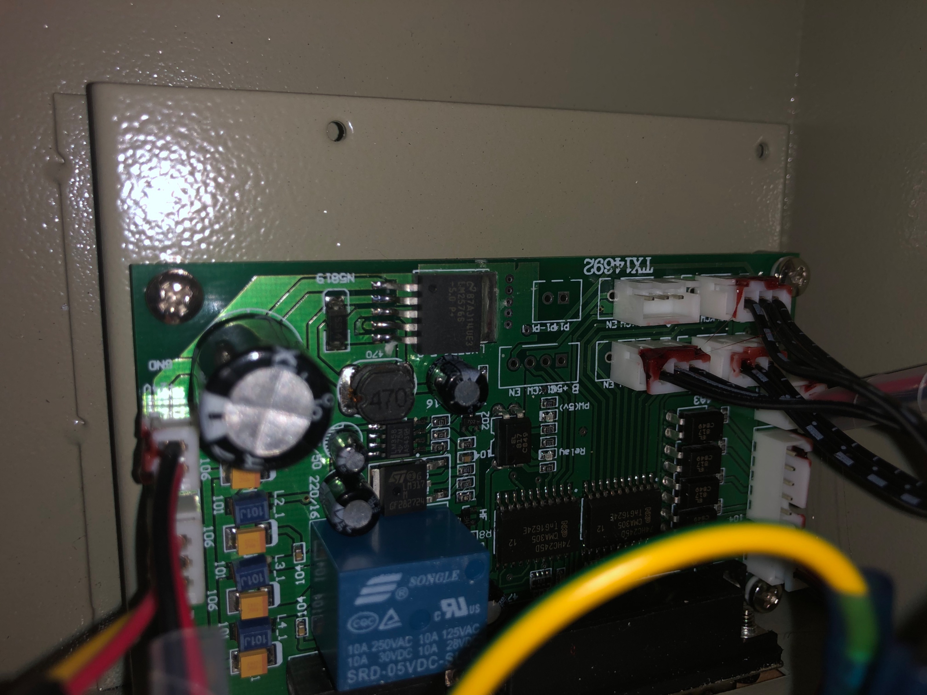

Since I found nothing here or elsewhere for my new CNCEST 6040 China Bomber, I configured it myself and share it here in case someone else needs it.
The pinout for this TX 14692 differs slightly from the more common TX14075...:
Pin 1 : Spindle PWM inv
Pin 2 : X Step inv
Pin 3 : X Dir
Pin 4 : Y Step inv
Pin 5 : Y Dir
Pin 6 : Z Step inv
Pin 7 : Z Dir
Pin 10 : Estop
Pin 14 : XEnable
Pin 17 : Spindle on
That's it for a vanilla 3-axis setting (no limit switches, no A-axis, no toolprobe - but the TX 14692 just like the TX 14075 seems to have the pins connected, so I will eventually add these later).

I am looking for information on the tx14692.
I have some information on the wiring but I'm missing the wiring of the tool motor, the 'end stop'.
Do you have a diagram to help me or a picture of your installation?
Thank you in advance and have a nice day
Pierre

sorry but I do nit have a wiring diagram and my router is running strong without endstops for two years now, so I never figured out the wiring of the non-connected port. But it seems quite obvious on first sight, since there are also 4-axis routers out there with the same board, there seems to be a complete a axis available.
My router has a spindle controller included in the electronics case - I never had to mess with the spindle control pins.
Sorry, small output I fear
