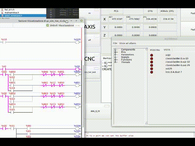

so need to connect some pin ..... the easy one .... "motion-digital-out-xx". Not understand and really no time to search for ... but seems there are a sort off double check, or filter for exclude at all middle-state signal, when change motion-digital-out-xx (really well done) so you need to activate command, declare pin number, establish what is 0 and what is 1 .... and use that for realize inversion of out .... a sample code:
for sure is limited connection and not the best .... but short way and work ..... for sure when motion plan work these is not right way to do, because you have not control over your MOTION-DIGITAL-OUT-XX .... so need find other way to do.... see you later
void MainWindow::motPinOn(int idOn)
EMC_MOTION_SET_DOUT dout;
dout.now=1;
dout.index=idOn;
dout.start=1;
dout.end=0;
cmd_one->write(&dout);
qDebug() << "Pin " << idOn << " on";
void MainWindow::motPinOff(int idOff)
dout.now=1;
dout.index=idOff;
dout.start=0;
dout.end=1;
qDebug() << "Pin " << idOff << " off";
void MainWindow::on_pbtn_on_pressed()
motPinOn(1);
void MainWindow::on_pbtn_off_pressed()
motPinOff(1);
}for sure is limited connection and not the best .... but short way and work ..... for sure when motion plan work these is not right way to do, because you have not control over your MOTION-DIGITAL-OUT-XX .... so need find other way to do.... see you later

So after more or less 52 hour of test and learning on old post and new one ... we can reach the goal ( yes .. I'm lazy and uses "udoS" user interfaces, however i did not use a rip-install ) ... but better is explain better the system so other with no time can reproduce same result without effort ... I don't mean without studying a little ... because this is not a restaurant it is an opensources course to learn how to cook in QT cpp some good dishes based on LinuxCnc !!
.... so for now gif with result ... about explanation ( the more curious will notice hal_priv.h in my project) ... see you later
