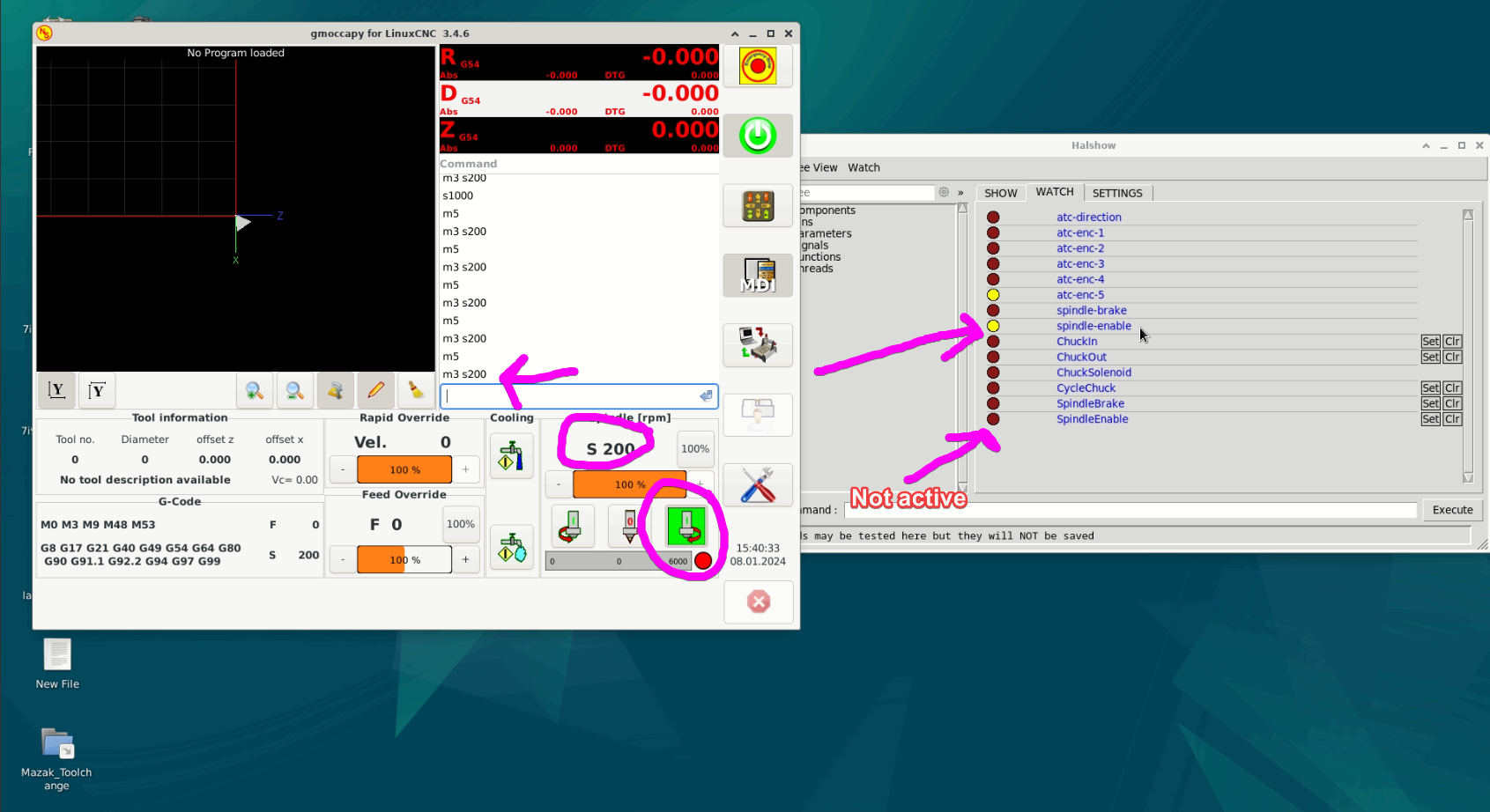

08 Jan 2024 08:56 - 08 Jan 2024 09:05 #290191
by abdulasis12
Replied by abdulasis12 on topic Powerchuck Hal component, operates hydrualic chucks, collet closers etc.
Hi MR. smc.collins

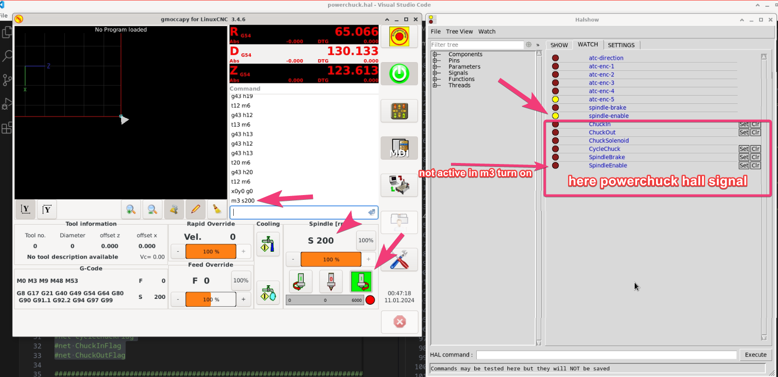

I'm read and think your share file .comp maybe can use with my Lathe cnc too.
I want same safty for when run spindle , chuck must Interlock ,not respond any signal and foot switch too.
Now I Download your Comp and complie to my Linuxcnc done.
I try open hall show and show
signal spindle-brake
signal spindle-enable
and list your signal Powerchuck signal
ChuckIn
ChuckOut
SpindleBrake
SpindleEnable
I try MDI
M3 S200
spindle-enable change to 1 but SpindleEnable from your component not change from 0 to 1 .
I must go to link something to your signal first ?
Please example some code for connect signal I'm newbie for linuxcnc .
Below I show some picture
Thank you.

[size=85]# Generated by PNCconf at Thu Jan 4 13:13:52 2024
# Using LinuxCNC version: Master (2.9)
# overwritten when you run PNCconf again
loadrt [KINS]KINEMATICS
loadrt hm2_eth board_ip="10.10.10.10" config="num_encoders=1 num_pwmgens=1 num_stepgens=5 sserial_port_0=0xxxxxxx"
setp hm2_7i96s.0.pwmgen.pwm_frequency 20000
setp hm2_7i96s.0.pwmgen.pdm_frequency 6000000
setp hm2_7i96s.0.watchdog.timeout_ns 5000000
loadrt pid names=pid.x,pid.z,pid.s
loadrt powerchuck
addf hm2_7i96s.0.read servo-thread
addf pid.s.do-pid-calcs servo-thread
addf hm2_7i96s.0.write servo-thread
addf powerchuck servo-thread
net ChuckIn powerchuck.ChuckIn #inputs to set DEFUALT CHUCK BEHAVIOR , connect to double pole switch with chuck out so it forces a binary behavior !!!!
net ChuckOut powerchuck.ChuckOut #these 2 parameters block each other. use the cyclechuck input to actuate the jaws
net CycleChuck powerchuck.CycleChuck #input to cycle chuck in either direction relative to current state connect to momentary footswitch or other input command to cycle jaws
net SpindleEnable powerchuck.SpindleEnable # Must be false to allow change in mode or state connect these to HAL IO pins etc.
net SpindleBrake powerchuck.SpindleBrake # Must be true to allow change in mode or state
net ChuckSolenoid powerchuck.ChuckSolenoid #output to solenoid to open chuck jaws, defualt behavior is for jaws to be closed use invert pin functions in hal if you need to flop this around
net SingleSwitch powerchuck.SingleSwitch # open is in, closed is out or invert your solenoids and switches as you see fit
net SingleSwitchEnable powerchuck.SingleSwitchEnable # use setp command to make this true of false, default is false, if you want to use 1 switch to set chuck holdingin or out
#net ChuckSolenoidFlag ############## these are just signals you can watch to see if your inputs and outputs are working.
#net CycleChuckFlag
#net ChuckInFlag
#net ChuckOutFlag
setp hm2_7i96s.0.dpll.01.timer-us -50
setp hm2_7i96s.0.stepgen.timer-number 1
# external output signals
# --- SPINDLE-ENABLE ---
net spindle-enable => hm2_7i96s.0.ssr.00.out-00
loadrt powerchuck
#net CycleChuckFlag
#net ChuckInFlag
#net ChuckOutFlag
# motion controller IO:
net tool-change-confirmed motion.digital-out-00 => iocontrol.0.tool-changed
[/size]Attachments:

10 Jan 2024 03:17 #290323
by smc.collins
Replied by smc.collins on topic Powerchuck Hal component, operates hydrualic chucks, collet closers etc.
The source code is heavily commented to explicitly explain how it works, I'm not sure i understand your question. Can you take a short video and walk me through your probem ???
The following user(s) said Thank You: abdulasis12

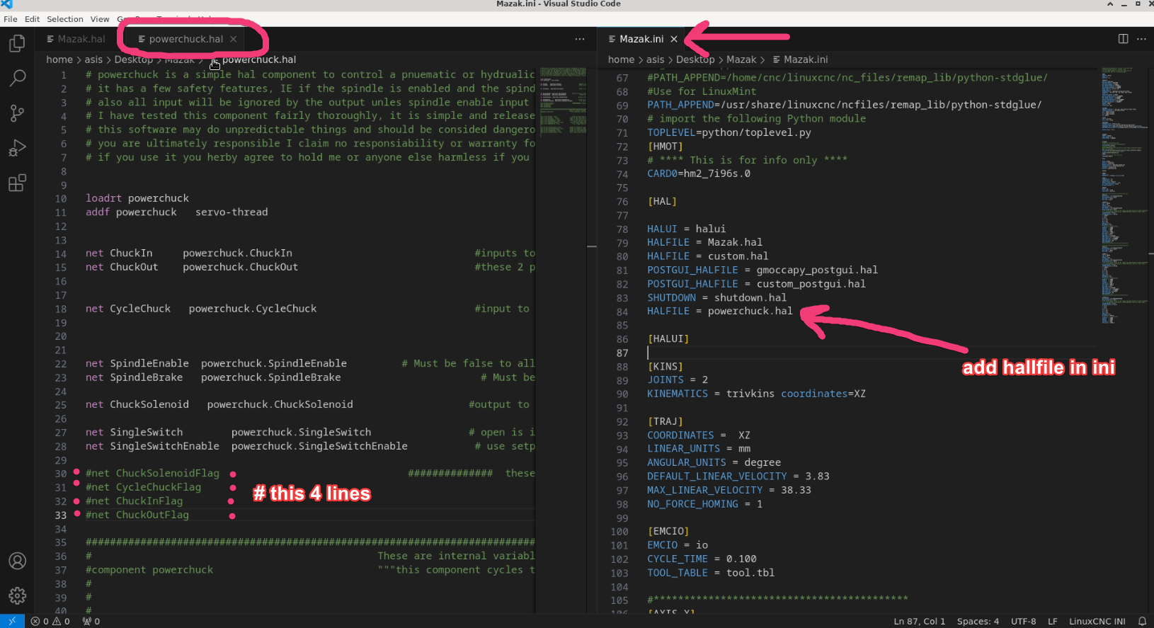

10 Jan 2024 17:50 - 10 Jan 2024 18:11 #290387
by abdulasis12
Thank you for respond my question. ^^"
Okay , now I renew about hall
I use your powerchuck.hal , I put it's into folder .
I add HALFILE = powerchuck.hal in .ini file.
I # 4 lines below in powerchuck.hal file.
#net CycleChuckFlag
#net ChuckInFlag
#net ChuckOutFlag
then details in my clip
CLIP Youtube
My question is:
What more for config to use your powerchuck.hal ?
How to link Signal input from switch to your variable signal ?
Can show some example code ? maybe I can Easier to understand ^^" .
Thank you

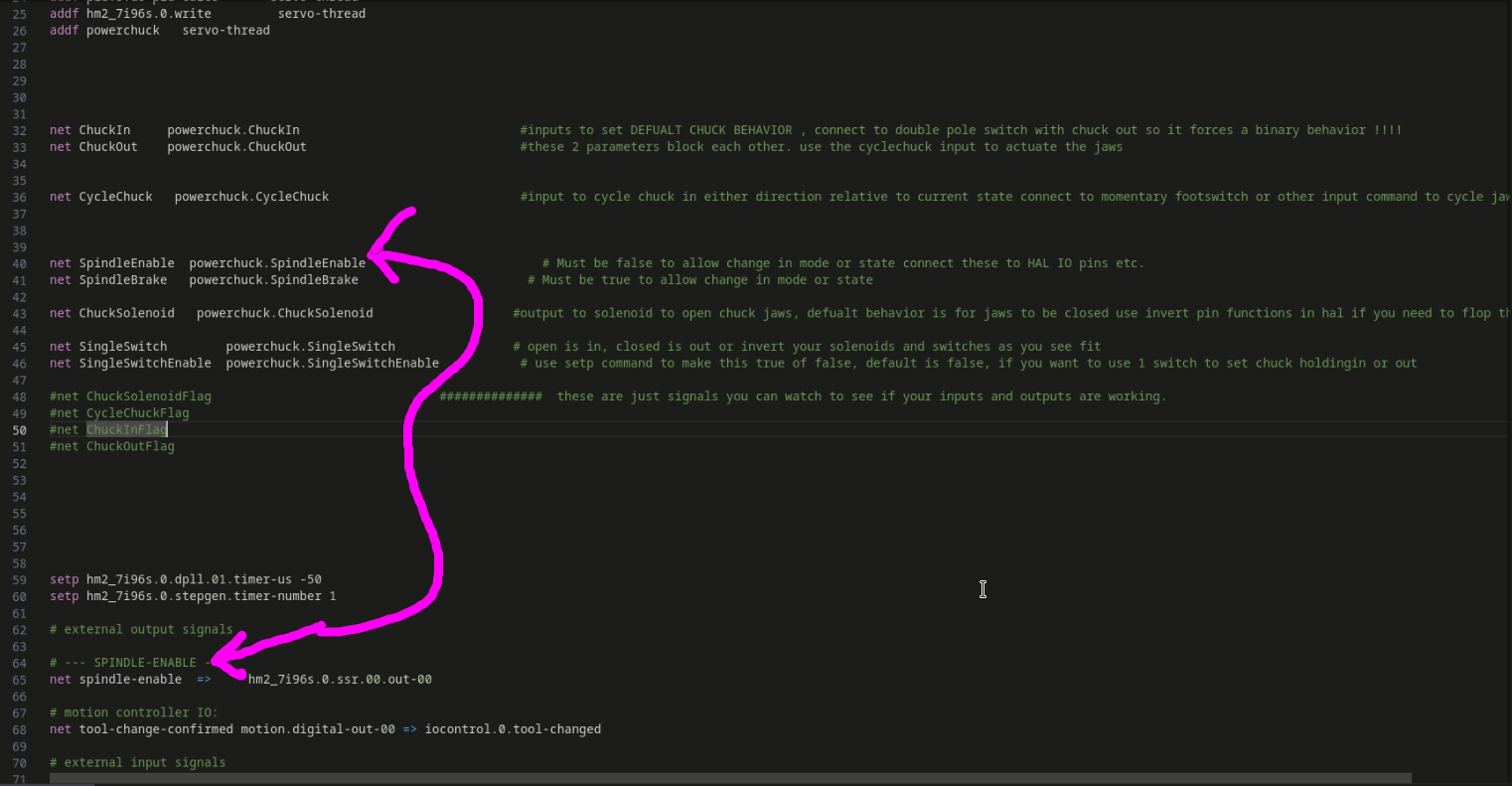

16 Jan 2024 03:14 - 16 Jan 2024 03:19 #290827
by smc.collins
it's been -4 F here for 3 days, I haven't been able to power up the lathe. Put powerchuck in the main hal file mazak.hal, and put those 4 lines in that mazak.hal file as well, load the component in the mazak.hal file as well. I didn't design this to get the signal outside of the main hal file. you'll also have to connect the spindle enable to the spindle.ena , spindlebrake to spindle brake signal etc. You will obviously connect your footswitch to the 7i77 input pins and it you have you want to reverse the grip of the chuck , you'll need to add wiring for the ID OD grip settings IIRC and I haven't looked at the source recently, the pin routes through the powerchuck hal component.
these all go in you mylinuxmachine.hal file if you catch my drift.

23 Jan 2024 16:14 #291434
by abdulasis12
I try change
net SpindleEnable
to
net spindle-enable
now it's can link signal and change other net too.
youe powerchuck.comp good for my CNCLathe I edit some and cut some function now working with my cnc
Thank you. ^^"
