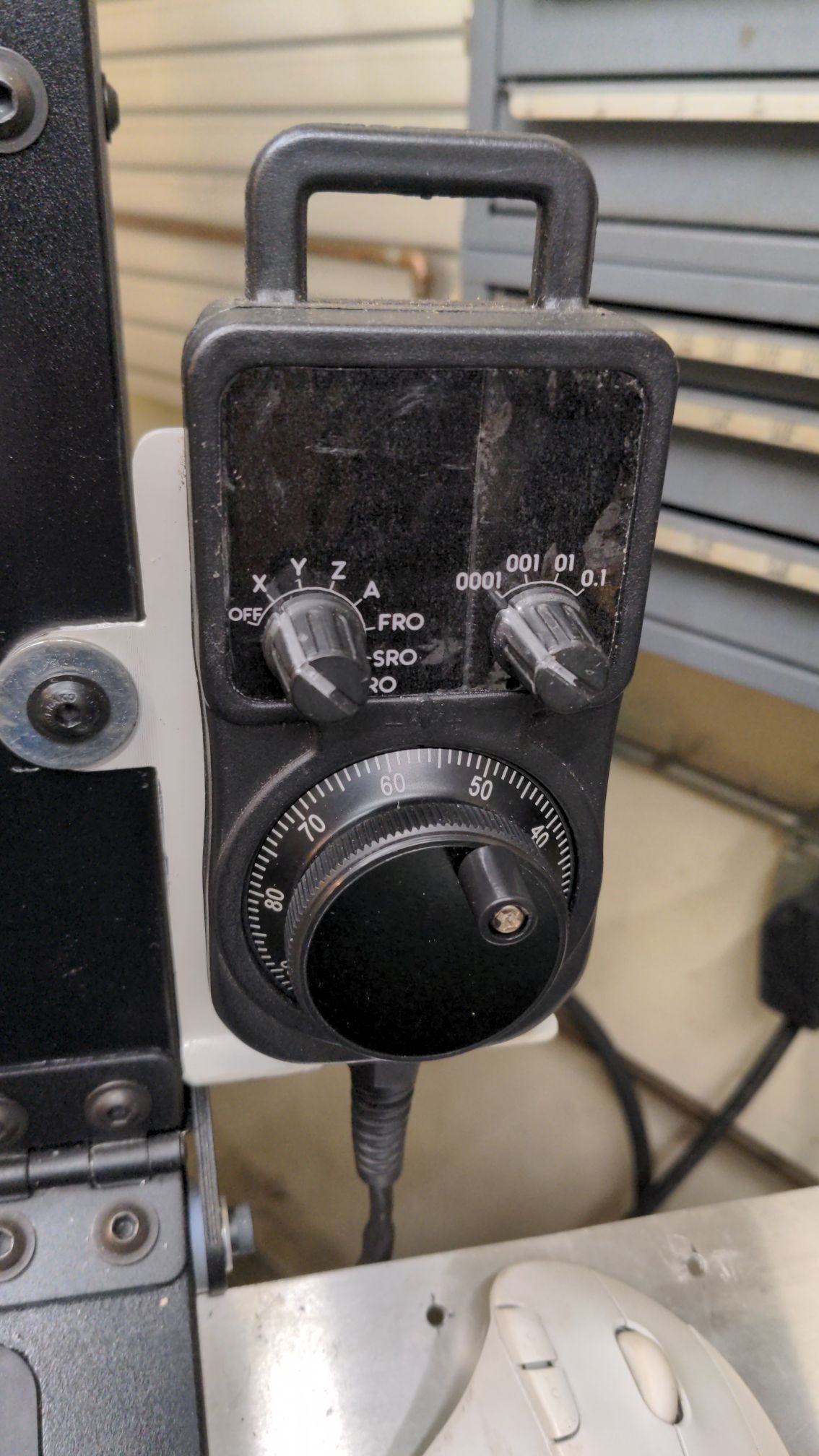

As requested, here's my take on it.
Note 1: This has not been curated to be a generic example; input numbers and other machine-specific values will have to be adjusted accordingly.
Note 2: I discovered that some - maybe all - generic MPG's (the 4/5/6 axis Amazon/ebay & similar non-USB) basically use 12-position selector switches. The number of detents is adjustable, and the manufacturer just sets the number of positions for that model and slaps the appropriate sticker on the front. Mine had screw terminals connected to 9 of 12 axis switch positions, but the switches could easily have conductors connected directly.
In addition, the coiled cable usually has a number of spare conductors permitting expansion of the various functions & increment selections. A quick soldering job changed my 4-axis, 3-increment MPG in to a 4-axis + 3 overrides, 4-increment MPG.
Note 3: The bulk of the MPG logic is in MPG.hal, but I've attached IO.hal as the SRO/FRO functions are handled in that one. IO.hal is used for all the physical pushbuttons on my control panel.
Note 4: The jog-speed function is pretty straight-forward. Turn the selector to "JRO" and twiddle the MPG encoder. The speed for a continuous jog is adjusted as a percentage of the maximum rate set in the INI file (or in the knob2float component). To jog, the selector is moved back to the desired axis and a panel button is pressed for pos or neg (continuous) or the MPG is turned (incremental).
Note 5: all 'loadrt' and 'addf' are located in a 'main' hal file. I didn't think it necessary to add that one, too.

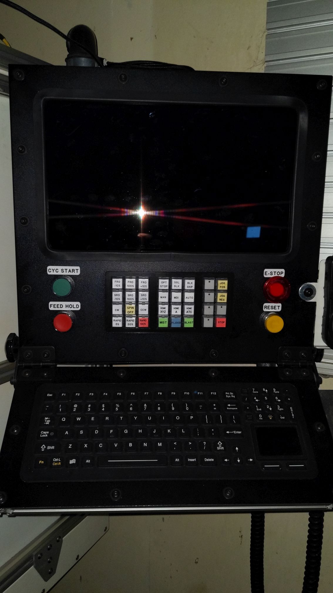

WOW spumco that's a nice setup you got their. I see you also use the 7i73. One of these day I will have to get
one and try it out. Does the encoder output a quadrature signal or a 1 count per click? If quadrature how do
you deal with the 4 count?
The JRO section is of special interest to me . I am making an HMI panel for my mill and the JRO override with
push button + and - buttons is on my to do list.
forum.linuxcnc.org/show-your-stuff/39443...mill?start=60#262607
Thanks again for posting your setup I am sure it will help a lot of people out.

The 7i73 has direct encoder inputs that work seamlessly with bog-standard 100-detent MPG encoders. The MPGs have quad A/B (or differential A/A-, B/B-) outputs that are connected to 5v-tolerant encoder-specific inputs. I'm ignorant of the actual details, but the 7i73's firmware is pre-configured so that you simply have "7i73.encN-counts" available for use in HAL. No need to set up a HAL software encoder component as the 7i73 just outputs counts up or down.
Super-easy, and there's enough encoder inputs that you can have separate MPG, FRO, SRO, and JRO (or RRO).
Minor complaint I have about the 7i73 is that only the encoder inputs (plus an additional single input) are 5v tolerant. The bulk of the inputs are 3v. Which means if you want to use some of the cheap 12-detent knob encoders for FRO/SRO that have a built-in pushbutton switch you have to figure a way to kludge up something to drop the voltage since the encoder switch outputs 5v.
Second complaint is that there are no pull-up/pull-downs on analog inputs, so if you want to use them as on/off IO you have to hand-wire some resistors. Not the end of the world, but having pull-ups/downs on-board with jumpers or dip switches would be favorite.
So while it's fine for the intended use (LCD + matrix keypad + MPG), it's a little challenging to use as a universal control panel interface if you want to standardize on the typical 24vdc and not have a bunch of different voltages in your panel to keep track of.
My keypad matrix is a DIY hand-wired 4x8 keypad based on some CherryMX keyboard switches. Some of the switches have LED's driven by 7i73 outputs (see the blink comp in previously posted io.hal). Also pretty easy to interface with LCNC & the 7i73 once I read the matrixkb comp instructions about 10 times.
