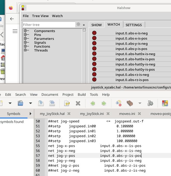

USB Joypad/Joystick Struggles was created by Project_Hopeless
I have an Axis/Vismach sim I'm trying to add a joystick to. I used PNCconf to setup a dummy config including the USB Joystick. I then copied some joystick lines to my Axis/Vismach sim. Halshow sees the joystick and the inputs toggle, the sim does not seem to respond.
The tutorials made it look simple. What am I missing setting up the joystick?

The below HAL line are copied form a joypad example I'm using.
Loading dumps at the mux2 declaration. How does one add additional mux2 signal handling?

Starting DISPLAY program: axis
mux2: already exists

Replied by Aciera on topic USB Joypad/Joystick Struggles
Do you have another line starting with ' loadrt mux2' ?
If not remove the underscores ( _ ) in the names and try again.

Replied by Project_Hopeless on topic USB Joypad/Joystick Struggles
Yes in a different hal file. When I copied a working sim as a template for mine, it created the ./moveo_cmds.hal from /tmp/tmp_basic_sim.tcl
In the _cmd file is loadrt mux2 names=J0_mux,J1_mux,J2_mux,J3_mux,J4_mux,J5_mux
If you want to load instances of the same rt-component in different lines you need to add this to the [HAL] section of your ini file:
TWOPASS = ON
linuxcnc.org/docs/html/config/ini-config.html#sub:ini:sec:hal

I recommend creating a basic configuration using stepconf or PNCConf tools (depending on what hardware interface you are aiming for), get all the limit switches and motors working and then modify that to add anything else you might need.

Just realized, I strongly advise against copying hal entries from a sim-config unless you really know what you are doing. The simulator creates HAL entries that have no relevance in a config for a physical machine.When I copied a working sim as a template for mine, it created the ./moveo_cmds.hal from /tmp/tmp_basic_sim.tcl
