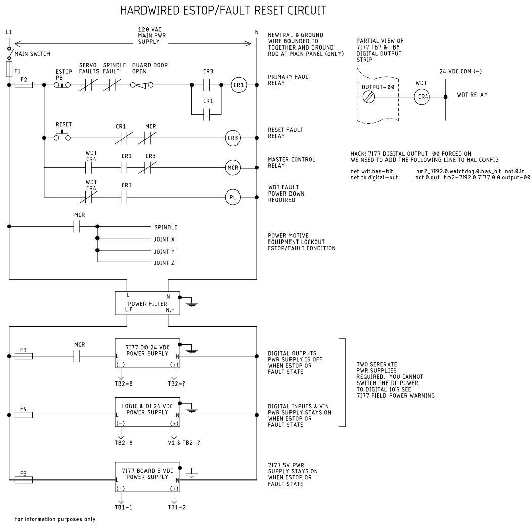

HARDWIRED ESTOP RESET CIRCUIT

L - MAIN SUPPLY LINE 120 VAC – L.F FILTERED LINE
N - MAIN SUPPLY NEUTRAL
PL- Pilot Light
A brief explanation to what this hardwired circuit does follows this diagram.
The wiring circuit diagram above is a hardwired circuit that will allow power to be removed from digital outputs, servos and spindle etc. Lockout power in case of WDT active.
The circuit achieves the following:
PL- Pilot Light
- If power is lost during operation the machine will not restart when power is re-established.
- If an Estop is activated or a fault occurs during operation, the circuit will inhibit (prevent) power to digital outputs, servos and spindle. The rest of the machine control circuit will stay ON; this will enable you to troubleshoot and resume operation without major reinitialization of the machine (maybe).
- Machine will not restart until all faults are cleared and operator presses reset button.
- If watchdog timer HAS bit, NO fault exists and reset button is pressed, the pilot warning light will turn ON, requiring operator to cycle main power off/on to try to reset WDT.
