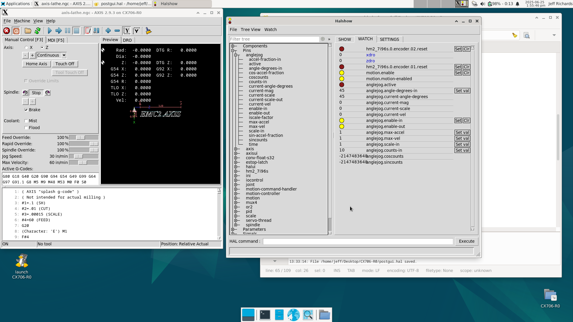

25 Jun 2025 13:38 #330869
by slowpoke
I added anglejog to the real time thread so I can see the parameters in HAL.
I was hoping to just do a little test jog from HAL before connecting coscounts and sincounts to the servos in HAL.
However both those outputs seem to have really large numbers. Please see attached.
is there anything obvious that I'm doing wrong?
Replied by slowpoke on topic Emulating lathe compound angle via manipulation of X & Z drives
I need a little assistance with anglejog please.
For jogging there is the 'anglejog' component:
linuxcnc.org/docs/stable/html/man/man9/anglejog.9.html
Thank you, and this is what I love about LinuxCNC, it seems that whatever somewhat custom idea you dream up LinuxCNC has the handle to make it happen. It's a tinkerer's candy store.

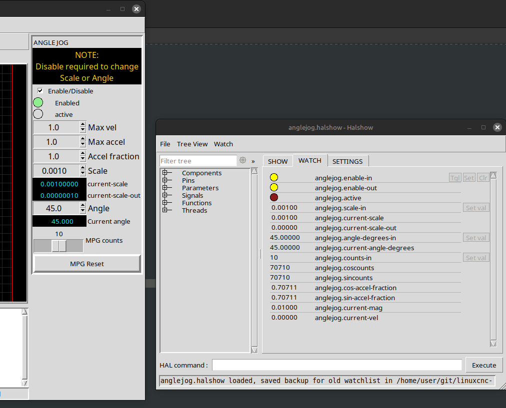

- Posts: 4819
- Thank you received: 2177
26 Jun 2025 01:39 #330884
Replied by Aciera on topic Emulating lathe compound angle via manipulation of X & Z drives
The following user(s) said Thank You: slowpoke

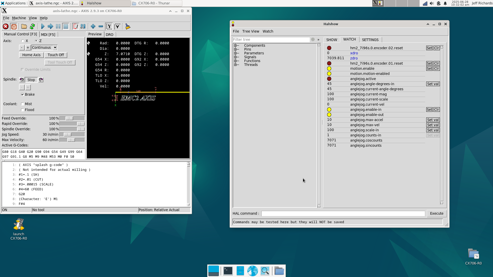

28 Jun 2025 09:40 #330956
by slowpoke
I have motion, however I don't understand the scaling, at the moment with the attached settings, 1 click of the MPG, yields 7.040" of actual Z axis movement.
Changing the scale value, does not change the distance moved it does change how fast the carriage moves; with 1 it's very fast, with 10 it's fast, and with 100 it's a nice comfortable jog speed.
I'm not sure how to correct the actual scaling?
I think I'm almost there...The most likely problem is that you have 'anglejog.current-scale' = '0'.
Note that the 'anglejog.scale-in' value is only sampled when 'anglejog.enable-in' is false. (See 'Notes' in the man page linked above)
You may want to have a look at the anglejog sim config :
configs/sim/axis/anglejog
- Posts: 4819
28 Jun 2025 10:38 - 28 Jun 2025 10:55 #330959
I have not used the anglejog component other than playing around with the sim config. As I understand it the 'scale' factor is used to avoid stair stepping in the tool path. Maybe the original discussion can give you some more clues:
forum.linuxcnc.org/38-general-linuxcnc-q...mode?start=10#253252
[edit]
I would tend to use the default values used in the sim config and adjust the
'max_vel', 'max_accel' pins (and possibly 'accel_fraction_in' for fine tuning)
[edit]
Last edit: 28 Jun 2025 10:55 by Aciera.

29 Jun 2025 14:25 #331011
by slowpoke
Thanks for all your help!
Okay, figured out what I was doing wrong (anglejog.N.iscale-factor), so I now have angle jogging working.
