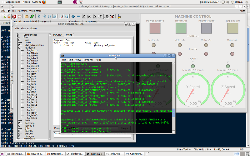

29 Dec 2011 19:22 - 29 Dec 2011 19:26 #16089 by dab77
Replied by dab77 on topic Re:how to auto-set widget?
When i try to use this line into the ini file:
GLADEVCP = -u gladevcp.py gladevcp.ui
using these files:
File Attachment:
File Name: gladevcp_files.zip
File Size:2 KB
i have this error:
gladevcp.hal:109: Pin 'gladevcp.max-value1' does not exist
infact, if i don't load my hal file, i can't see the pin:
p.s. another question for you, in the .py file instead of this line:
inifile = emc.ini(os.getenv("INI_FILE_NAME"))
how can i write directly the name of the file? ..i couldn't..
thanks, Davide.
