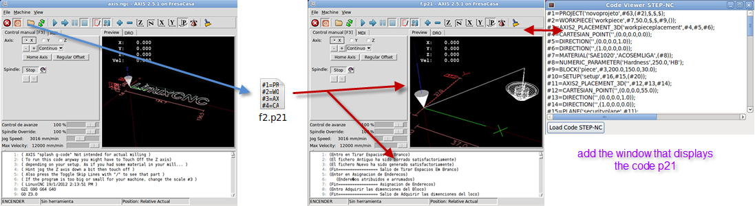

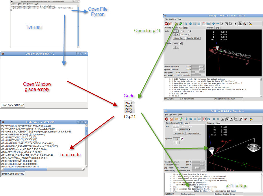

Hi everyone,
I try to use the EMC_SourceView, but after several attempts yet did not know how to use it.
I want to say best my idea to know if possible:
I have a format code "XXXX", I create a filter that passes for "XXXX" to code G / M, So far so good,
Then I want to put a window where you see the code "XXXX", after it is opened.
I made a glade with python program that opens the file, and I want to add it to the Axis GUI, but I need to run the archiyo. py of my program and do not know how?
annex a picture 1 to better understand

- BigJohnT
- Posts: 6999
- Thank you received: 1176
26 Sep 2012 13:17 - 26 Sep 2012 13:18 #24645
by BigJohnT
Replied by BigJohnT on topic Re:how use the
I "think" I know what you want to do. You want to pass your p21 file through your python filter then on to Axis.
Look at the Filter section of the INI chapter in the Integrators manual.
When you "open" your p21 file in Axis it will be run through your filter program which needs to output G code to standard out and that will be loaded into Axis.
John
John
Last edit: 26 Sep 2012 13:18 by BigJohnT.

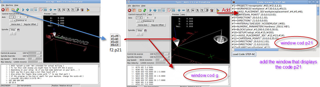

meduag wrote:
I know this isn't what you are asking for, but I guess that the filter programme could include the original code after a comment character, in the G-code programme.
Otherwise you need to edit the Axis GUI, and nobody understands that except the author.
I already did that
, now I want to add a window to view the code P21 that was converted
