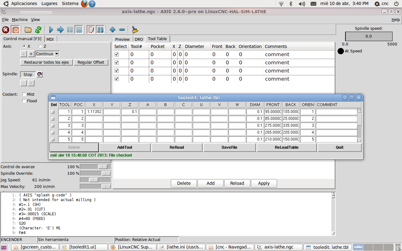

hello
tooledit can embed in AXIS screen, I have seen the option in GLADE, although know not much of programming and programming gladevcp, just let me know if this is possible.
I tried from glade widget tooledit creating and trying to copy files and tooledit.gtk.glade tooledit.widget Cmorley, but I have not been successful.
Any help would be well received in advance thank you very much.
leave a picture of what I want to do
jorge viloria
jorge viloria

Jorge
This is because tooledit widget does read the ini file to find the path tool your tool file.
I think we can do it in the gladeVCP loading command...
The command is something like this:
tooledit1t.set_filename("/home/chris/emc2-dev/configs/sim/gscreen/test.tbl")
I'll see if i can figure it out.
Chris M
Chris M

Replied by cmorley on topic tool edit gladevcp insert axis question
Jorge
that line is for testing only. tooledit_widget.py was not meant to be loaded directly.
It was meant to be loaded using glade or gladeVCP.
I could change it to look in the INI file but you'll have to wait for that.
I never thought of embedding it in AXIS.
Chris M
Chris M
ok you need to make a file and put it in your config folder.
lets call it tool.py
change the path to the path of your tool file.
then load your glade panel with a command similar to this:
EMBED_TAB_NAME=Tooledit
EMBED_TAB_COMMAND=halcmd loadusr -Wn gladevcp gladevcp -u tool.py -c tool -x {XID} tooleditpanel.glade
of course using the name of your glade panel.
Chris M
class HandlerClass:
def __init__(self, halcomp,builder,useropts):
tooledit = builder.get_object("tooledit1")
tooledit.set_filename("/home/chris/emc2-dev/configs/sim/gladevcp/sim.tbl")
def get_handlers(halcomp,builder,useropts):
return [HandlerClass(halcomp,builder,useropts)]
Chris M
