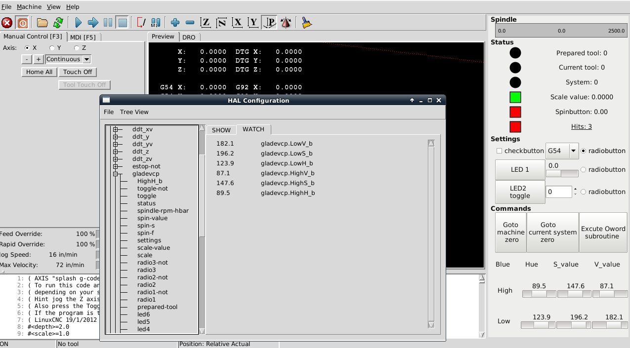

10 years 11 months ago #65185
by markder13
connect to scale was created by markder13
for a new project with vision I'm working with openCV an linuxcnc. I'm able to reconise the markers and control based upon the location of the markers with the pyton linuxcnc command
However I would like to control the setting of opencv by gladevcp. How do I read the values of my scales in python file. See attached screen shot of gladevcd. the pin that are in use. I do not understand the what needs to be change in the exampel file
Any guidance would be helpful to get the readings for use in python.
Mark
Code:
c.mode(linuxcnc.MODE_MDI)
c.wait_complete() # wait until mode switch executed
c.mdi('G0 X%d Y%d Z.5' % (x_g/10, y_g/10))

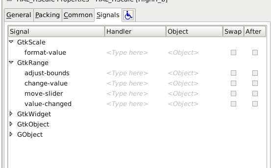

- markder13
- Topic Author
- Posts: 9
10 years 11 months ago #65209
by markder13
Replied by markder13 on topic connect to scale
Dear Norbert,
Thanks for your feedback. I think I can not connect the callback in glade. Which property do I need to select. (see screen dump).
I tried several options but I did not get it working. (I use the HAL_Hscale and not the HALIO_Hscale)
I have add the UI and PY file
On openCV if you have a question please let me know, if can help
Thanks.
Mark
Thanks.
Mark
- Posts: 6803
- Thank you received: 2181
10 years 11 months ago #65229
Replied by cmorley on topic connect to scale
value_changed is the one to use

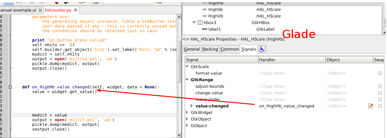

10 years 11 months ago #65271
by markder13
It Works.
the correct code for pyton is:
Note that the _adj is not there.
My lesson learned: (and hopefully also for other newbies') the text in glade under Signals -> GtkRange -> value change in Handler box is: on_<name of widget>_value_changed is to be repeated in the python file.
See screen shoot.
Mark
Code:
def on_HighHb_value_changed(self, widget, data = None):
value = widget.get_value()
See screen shoot.
Mark
