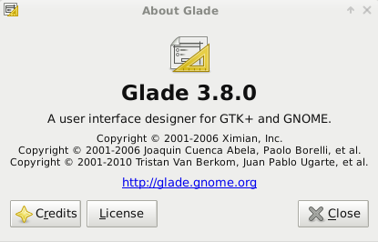

Thank you for your response.. I attached a screenshot of about window..

Glade 3.8 is pretty stable, I expected to see 3.16 which the gui is flaky for sure.

Hallo John,
I just tested it here on Debian Jessy.
Glade 3.8.0 crashes adding Gremlin Plus
Glade 3.8.5 loads Gremlin Plus without any Problem.
3.8.5 is the latest Glade supporting GTK2, all newer Glade Versions do only support GTK3, so at this development state they are not compatible with GladeVCP.
