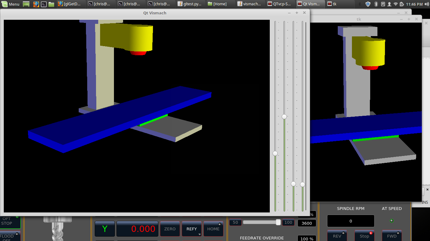

- Posts: 7368
- Thank you received: 2181
18 Dec 2020 07:56 #192308
Replied by cmorley on topic is it possible to embed vismach into gladevcp?
- Posts: 7368
18 Dec 2020 23:05 #192404

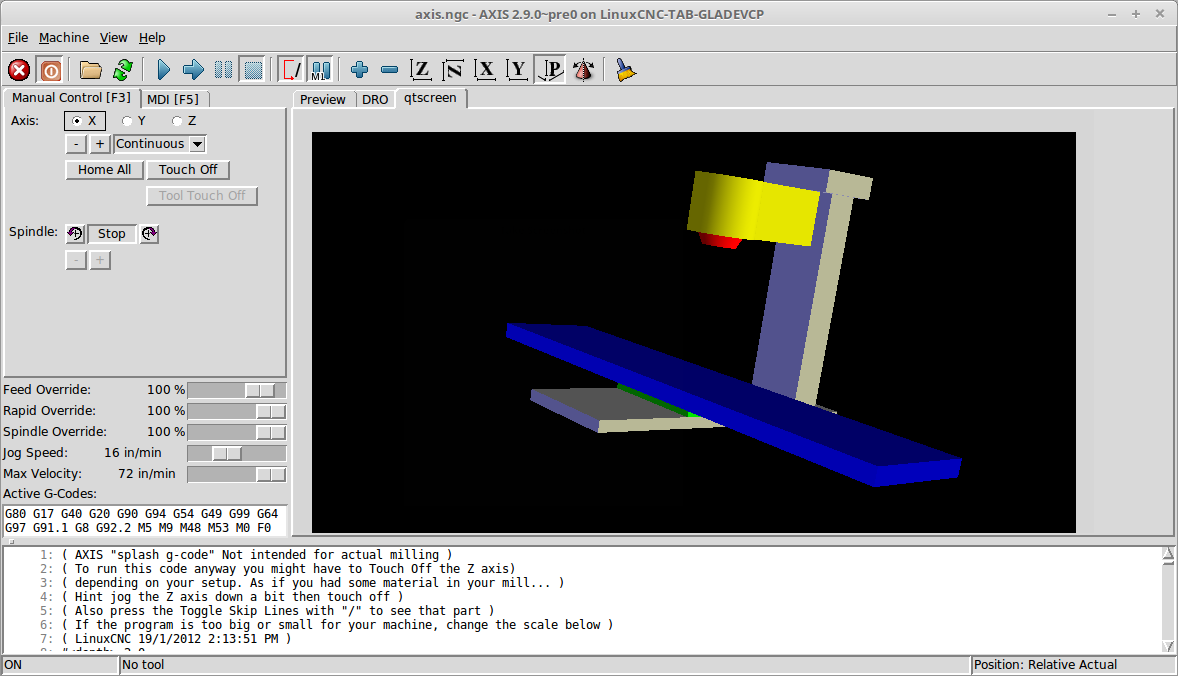

The following user(s) said Thank You: chimeno, tommylight, Aciera
- Posts: 22025
- Thank you received: 7500
18 Dec 2020 23:31 #192408
Replied by tommylight on topic is it possible to embed vismach into gladevcp?
Code looks nice, thank you.
code is still raw

31 Dec 2020 02:04 #193600
by thang
Replied by thang on topic is it possible to embed vismach into gladevcp?
That is amazing, did you find a way to export X window from vismach?
- Posts: 7368
31 Dec 2020 05:01 #193604
No I converted vismach to use pyqt, which can export the X window
