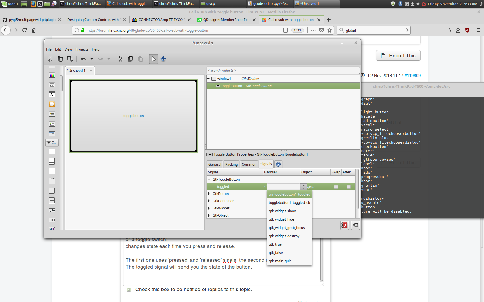

It's not clear to me if you want a momentary switch:
press and it automatically releases.
or a toggle switch:
changes state each time you press and release.
The first one uses 'pressed' and 'released' signals, the second uses 'toggled'.
The toggled signal will send you the state of the button.
I'm going with toggle button, but the process is the same.
Here is a picture of setting the signal
You can change the name of the signal - usually it uses the name of the button (like it automatically suggests.)
You would also add two mdi actions for the calls to your OWord routines. ( we will call them mdi_action1 and 2
Then in your gmoccapy handler file you would add a function such as this:
Now the button will call the functions
(as long as I haven't made any mistakes)
Chris M
