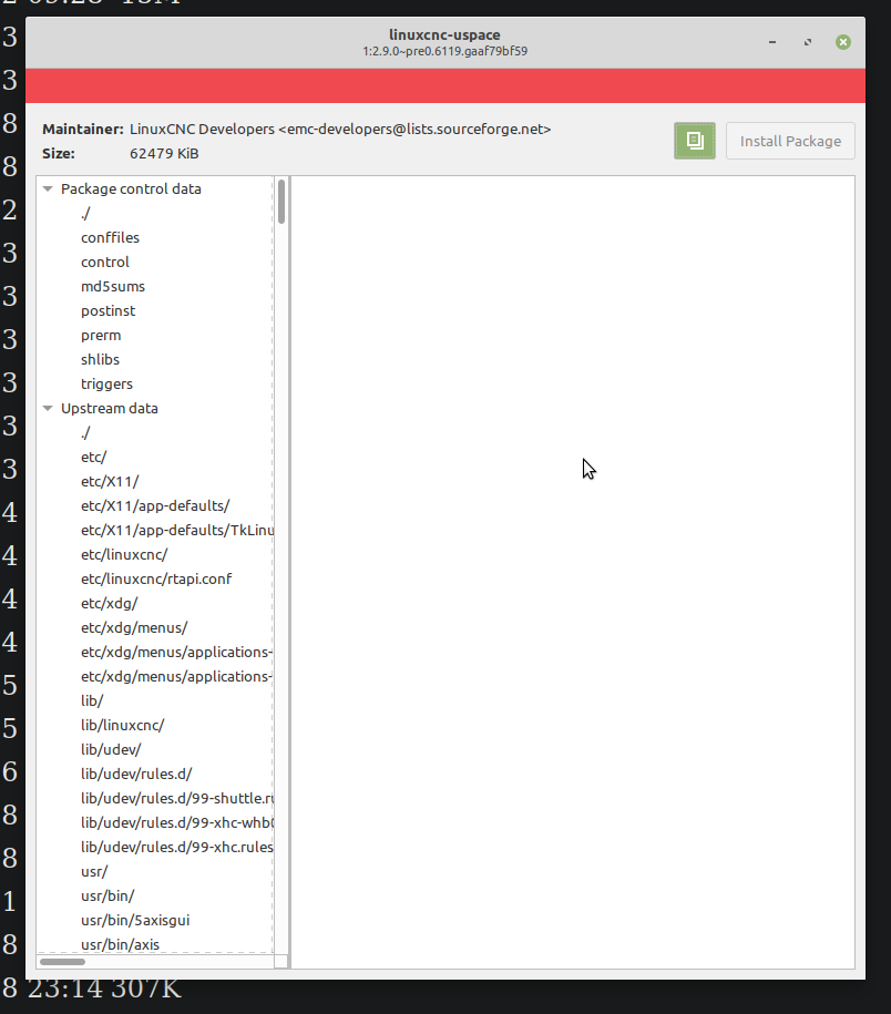

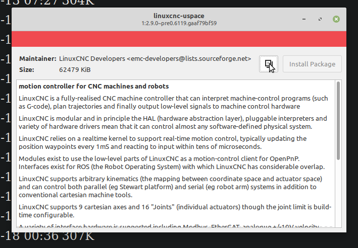

23 Mar 2022 17:51 #238120 by tommylight
I don't know where to look to check what linuxcnc installs where when it does a deb install of master to report an issue on github / more importantly a fix.
Click on the button the mouse is over:
You get a list of every file and where it will be copied:
