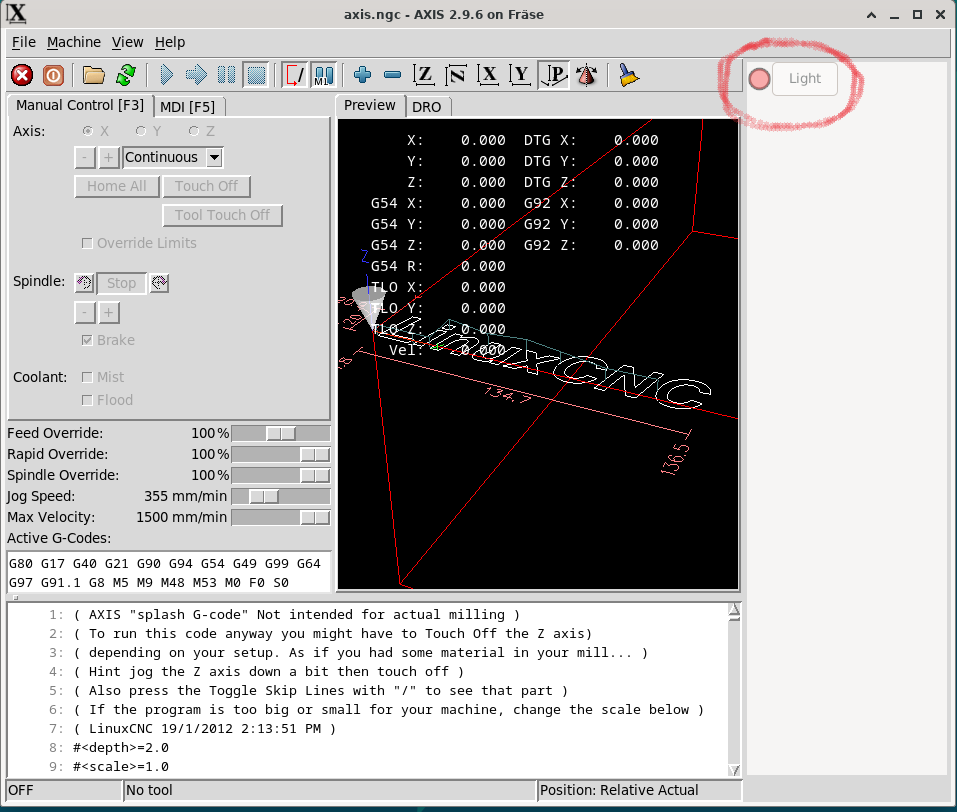

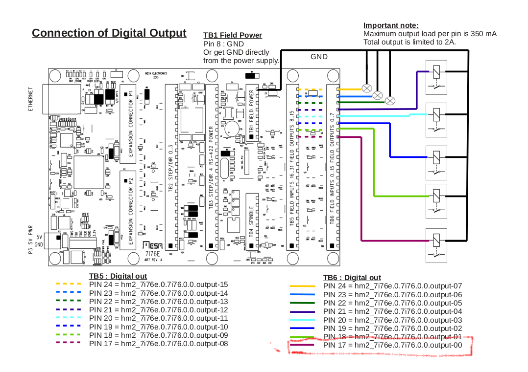

Hello,
I would like to have a header on my Linuxcnc interface that switches Pin17=hm2_7i76e.0.7i76.0.0.output-00 on and off on my Mesa7i76e. So far, I have created an LED and a button in Glade. This already appears on the Linuxcnc interface, but no control content is stored. How do I proceed? I tried to do some preliminary work on the Glade page, but failed. What do I need to do and where?

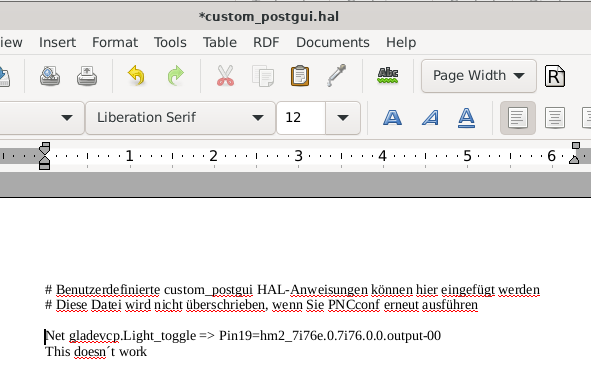

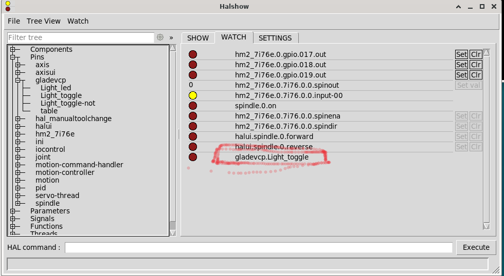

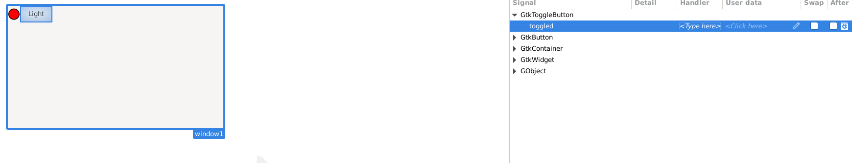

I only became a Glade user today... so I don't have any experience yet. Please take a look at the attachments. I have the following questions:
Do I have to enter something in Glade -> Light Button -> Signals -> Handler? Do I enter this handler in postgui?
I entered the command in postgui. This does not start linuxcnc. Do I have the correct command from Halshow for postgui.hal?

10 Oct 2025 17:25 #336203
Replied by Aciera on topic Button on Linuxcnc interface that switches an output on Mesa 7i76e on and off
That does not work because you have forgotten to give a signal name after the 'net' command.
The regular hal files are read before the gui has loaded so if any gui related halpins are used in these files you will get a startup error because those pins are missing. The postgui halfile is read after the GUi and the custom panels have loaded.
Not sure I understand this correctly but halshow does not make any distinction between postgui and regular hal files.I entered the command in postgui. This does not start linuxcnc. Do I have the correct command from Halshow for postgui.hal?

10 Oct 2025 20:03 #336221
Replied by andypugh on topic Button on Linuxcnc interface that switches an output on Mesa 7i76e on and off
If your Glade UI element is of type "Hal button" then the HAL pin will be created automatically and no handler file is needed.
