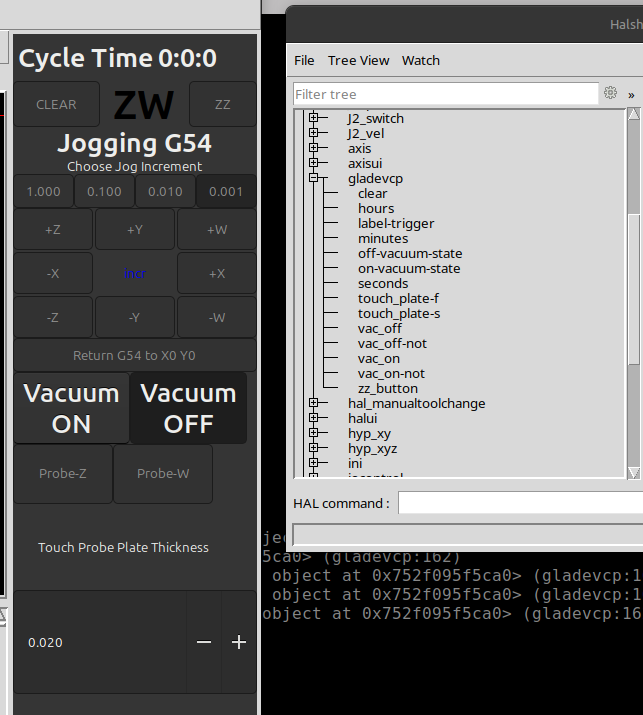

I am working on updating the control an older Linuxcnc machine. I need to make some modifications of the old GladeVCP it uses. Are there any steps or instructions for updating older GladeVCP files (from Linuxcnc 2.7) to current versions of GTK/Glade for Linuxcnc?

I'm still not getting anywhere with this. This GadeVCP worked fine with Linuxcnc 2.7 on Debian 7, but on the upgraded control PC running Linuxcnc 2.9 on Debian 13, The Python handler file doesn't seem to work. The problem is that it isn't creating any of the hal pins that it used to. I've tried this with several different GladeVCPs that I had created a number of years ago for these machines. and all of them are giving similar issues.

The first thing I'd try is to load your glade file in the Glade (Version 3) editor and save it.
Also check for error output when starting your config from a terminal.

Not able to help here but this is a continuation of the deprecation of Python 2.7 back when Debian Bullseye (v 11) was released. You need to convert your handler to Python 3.

I have opened, modified and re-saved the Glade file in the newer Glade editor. The Glade file seems to open fine but none of the hal pins created in the handler file show up. But I have no idea how to fix the Python file. I tried running it through 2to3 but it didn't find anything to change. I REALY don't understand Python and I was barely able to make this one sort of work originally. (The fact that most of the included Linuxcnc example config files don't seem to work for similar reasons isn't helping.)

I tried something with your files. This changes made the pins show up, but still many errors displayed in terminal.
#!/usr/bin/env python3
import hal_glib
import hal
#import pango
from gi.repository import Pango
Last edit: 20 Mar 2026 14:20 by MaHa.

Changing that does not make the hal pins from the call back file work for me. I can only see the hal pins created by the hal glade widgets.

Thanks that's at least a big step in the right direction. Now I just need to get the label change working again. (That's what all the Pango stuff did) It was supposed to change the ZW at the top center to ZZ and change the color of it when the "gladevcp.label-trigger" hal pin changed to true.
