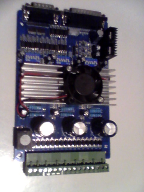

19 Jan 2015 20:36 #55178 by 1qay
Hi!
I just bought what seems to be tb6560, but at first look it is bit different. I google web and finde no such cart. It is simmilar to standard tb6560, but peaces are rearanged. Does anyone have that board type and have tryed to configure it? I do not wish to start all from scratch...
Tnx.
Dave
