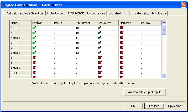

I had CNC cutter working with Mach3. It works.
Parport in 10 is shared limit switch (all X+, X-, Y+ Y-)
Parport in 11 is X home
Parport in 12 is Y home
CNC configuration made with StepConf wizard
