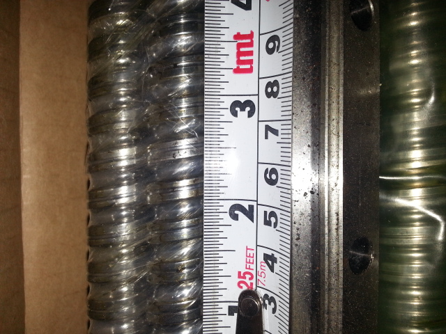

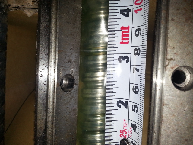

Screws 20mm
Screws 25mm
I think its same tpi.
Was told its 10tpi.
Will anyone help confirm this?
Cause I dont see 10 lines per inch...
The manual says 10 lead..
Screws 25mm
Was told its 10tpi.
- cncbasher
- Posts: 1744
- Thank you received: 288
30 Nov 2013 20:47 #41257
by cncbasher
Replied by cncbasher on topic Spindle & Servo selection
it's usual if the screw is metric dia then the lead pitch is metric too so i'd take them as being 10mm pitch
- fannlow
- Posts: 106
- Thank you received: 3
30 Nov 2013 20:49 #41258
by fannlow
Replied by fannlow on topic Spindle & Servo selection
that being the case, i take it 1 rev = 10 mm?
- cncbasher
- Posts: 1744
30 Nov 2013 22:07 #41261
by cncbasher
yes that is correct
