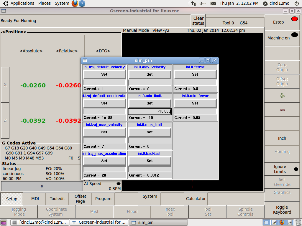

02 Jan 2014 23:04 #42290
by dgarrett
Replied by dgarrett on topic Ferror and Min_Ferror
there is a patch for master to make hal pins for several ini file items:
www.panix.com/~dgarrett/stuff/inihal.patch
the patch needs testers before it is added to master.

- LAIR82
- Posts: 336
- Thank you received: 9
03 Jan 2014 00:56 - 03 Jan 2014 00:58 #42295
by LAIR82
Replied by LAIR82 on topic Ferror and Min_Ferror
I added it, and the screen pops up with the added variables that can be adjusted.
Is it just a demo right now? How do change which axis you are adjusting?
Would this be integrated into the current Calibration Window?
I changed some numbers around, but did not see it reflected on my INI file.
Here is a pic for those that are interested.
Rick
Rick
