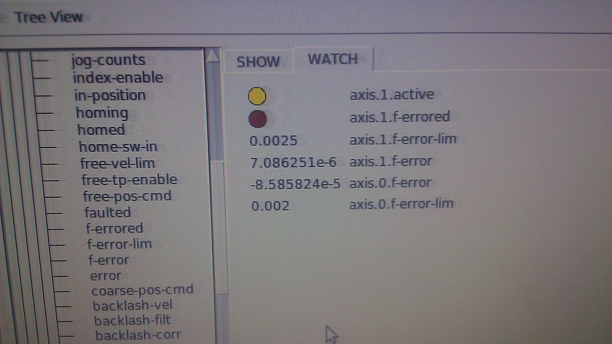

- Posts: 19096
- Thank you received: 5270
02 Apr 2014 10:00 #45494
Replied by PCW on topic following error and velocity
I don't see any large spikes in the video, but lots of places where the
following error is small enough that it changes to scientific notation
( like your screen shot that shows a .000007086251 error on axis 1
and a -0.0000585824 error on axis 0 )
I would widen your ferror _and_ min_ferror limits to try and see whats going on
(especially when it wont start)

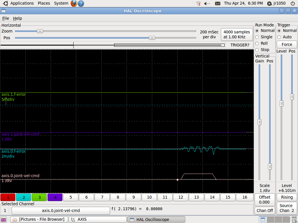

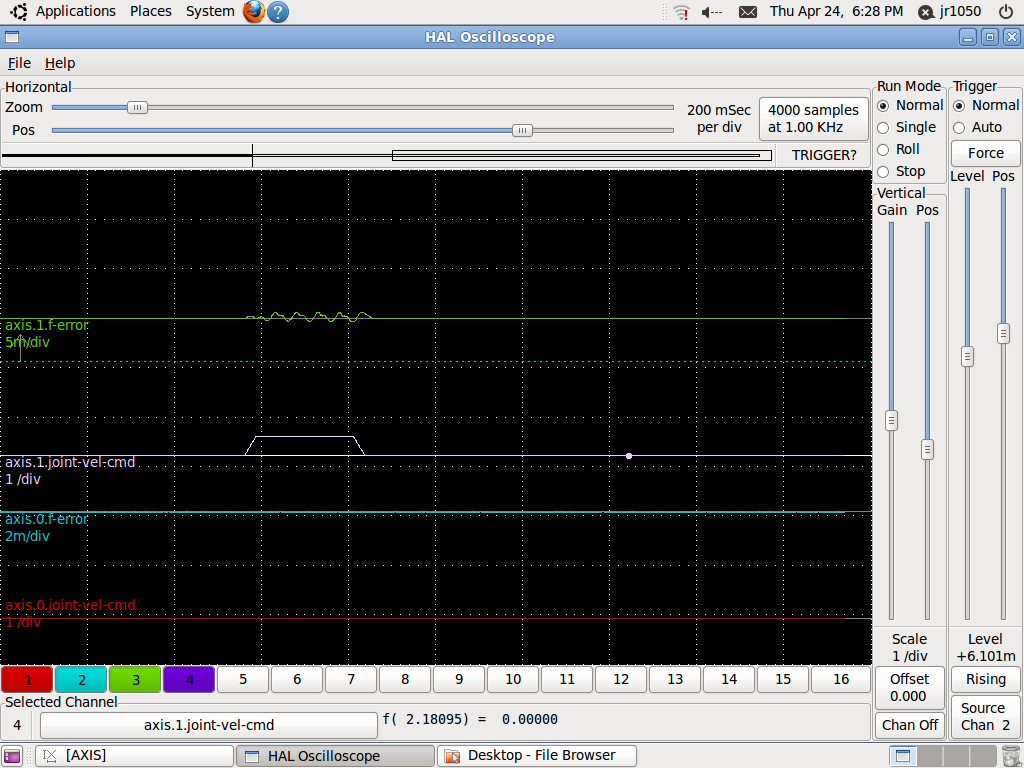

25 Apr 2014 07:33 #46296
by JR1050
Replied by JR1050 on topic following error and velocity
Over the last week or two, both x&y servo were rebuilt. Tach comms and motor comms were trued up, bearings repacked, new motor brushes installed and inside and out scrubbed clean. After reinstalling, I have the same following error issues and vibration. I set up another resolver with new cable and also tried a new tach cable, same results. The PWM is set for 24k and the excitation for 2500 htz. Below are plots of the following error for x &y, they seem to show the same pattern of noise.
Any suggestions?? Thanks
JR

- Posts: 19096
25 Apr 2014 09:05 - 25 Apr 2014 09:11 #46297
Looks like a periodic position error in the resolver (especially if the noise frequency scales with speed)
or possibly tachometer issues
(knowing the resolver scale would help here)
Possible causes:
Overdriven 7I49 input (try channels 3,4,5 with W2 down)
Wrong resolver connections (make sure rotor is to connected to RESDRV + and RESDRV-)
and the peak ACV amplitudes on SINE and COSINE windings are equal (need to
rotate slowly to find peaks)
To check for tachometer issues drive motor with fixed Voltage
(A fixed velocity command with no feedback so best done with motors decoupled from linear axis)
If there is still noise/vibration, its likely a tachometer issue
Possible causes:
