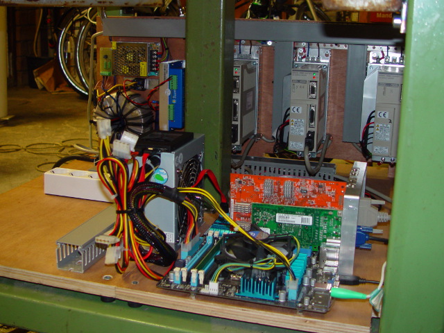

26 Apr 2014 14:31 - 26 Apr 2014 14:34 #46331 by DaBit
OK, I have modified homing.c
Wiring is coming along nicely too:
Not done yet (switches, cable chains, much more wiring..), but I can test synchronous homing on my proven BF20 before moving on to unknown territory.
