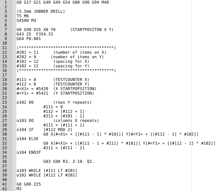

- MaHa
- Posts: 542
- Thank you received: 241
07 Feb 2019 23:00 - 08 Feb 2019 17:59 #125959
by MaHa
Replied by MaHa on topic Array offset
This modification doesn't make unnecessary moves. Also no G92, Sub,and repeat. The problem in your routine is, the xy movement after o100, G83.
Because sometimes brackets get lost in the uploaded files, there is a screenshot, how it should look.
EDIT:
Toolpath changed to: ZigZag orthagonal along X
EDIT:
Last edit: 08 Feb 2019 17:59 by MaHa. Reason: Toolpath changed to: ZigZag orthagonal along X
