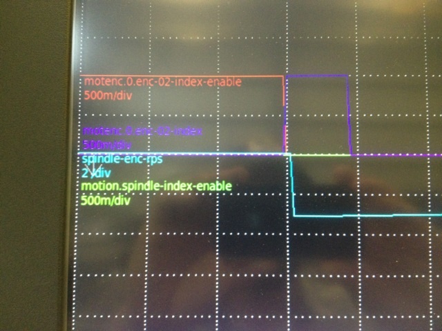

Thanks JohnT. I tired it and here's what I got: I monitored motenc.0.enc-02.index, motenc.0.enc-02.index-enable, and motion.spindle-index-enable. Unlinkp worked to remove the signal between motenc.index-enable and motion.spindle-index-enable. Toggled motion-index-enable high. It went high. Then ran the spindle at 1RPM. I could see both Motenc signals changing (Index was a pulse, Index-enable was more square, maybe 50% on, 50% off). Motion-index-enable did not drop out. It did not change at all; stayed high.
My question is: how is it going to change without the index signal? Something internal to the motion module pulls it low? I don't agree that this is a wiring problem.
I need to figure out what it is that G95 uses for revolutions.

I think Johns instructions have a little error, you check the index hardware via the encoder pins,
not motions pins
You want to manually setp motenc.index-enable and then monitor motenc.index-enable
once set it should get cleared at the index position
not motions pins

Ah, makes sense now. That seems to be working great. However, the G95 is still going exactly 40 times faster than it should.
Could it be some scaling problem on either my commanded or feedback spindle speed?

Not sure how motenc driver scales the encoders, but
If you have a 1024 line encoder, the encoder scale should probably be 4096
so that motion.spindle-revs is scaled in spindle revolutions (1.00 = 1 turn)
Also the motion.spindle-speed-in must be fed the spindle velocity in RPS (not RPM)

I had it in RPM's.
Good find. Thanks for the help. Feedrate looks good now.
