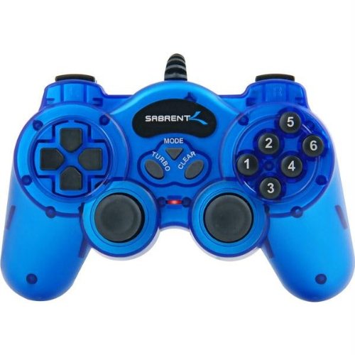

So I have been playing with setting up a Joypad pendant and have been getting along OK thanks to the WIKI and forum searching but I have a few questions about what to set up and why?
I can jog proportionately using the joysticks which is very cool.
I saw the article on setting up incremental jog which would also be handy BUT as implemented it uses the same analog sticks. I have a secondary direction pad on my joypad, maybe I should set that up as incremental jog? That way continuous and step feeds are separated?
It would seem nice to always have incremental jog ready to go, maybe with the addition of a safety button? Would I be better off saving the DPad buttons for discrete buttons to use later?
I guess the crux of the inquiry is what a pendant should have, or at least what should a joypad pendant have for a small size milling machine to be most effective.
I attached a pic of the joypad in question; I mostly got it because of the extra buttons on the face.
I was thinking of using analogs for continuous, triggers 1-3 for continuous feeds and D-pad as X-Y with 5-6 for Z and trigger 4 as safety for incremental. That leaves 1-4 unused and available.
Ohh yeah, one other question and this one may be more technical…. Is there any way to access the mode/clear/turbo buttons if they aren’t listed in the hal config/pins/input listing for the joystick?
22 Jul 2014 17:39 #49008 by Rick G
Really just depends on what type of work you are doing and how you go about doing the work. Whatever is comfortable for you.
My guess is if they aren't showing up then you can't access the buttons.
IMHO, a joypad will have very limited use on a mill. I do use one on my plasma cutter as I only need to jog to the general area where the cut will begin. On a mill you need to touch off your tools and material and a MPG seems to be the best way to do that. The next best thing would be to be able to move 0.001" with each button press. In the beginning I used the keyboard in incremental mode to touch off.

23 Jul 2014 20:07 #49054 by Rick G
Yep, and to be safe I like to use a safety button so that you do not accidentally jog the machine when you do not want to (drop the joypad, place a book on it, etc.)
Also if you use the joypad and want to move X you want to be sure Y does not also move.
I set up 3 incremental move sizes, .001, .005 and .010, so to do an incremental jog select the size of the move with one button and hold it and then use the joystick to make the move.
So to move X .001 hold button one then move the X stick all the way. You can set a high threshold on the joysticks to prevent a slight movement in the Y direction when moving X to cause Y to also move.

24 Jul 2014 21:58 #49089 by TroyO
I have incremental and continuous jog set up now, as per the WIKI pages. After "Playing around with it" some I am comfortable that I can increment accurately and also control the continuous jog well enough for gross positioning. Feedback for which mode I’m in is next… I’m studying the examples and trying to piece together enough to figure it out.
It’s very fun to control “Real motors’ with a joypad, LOL.
I do have one slight…. Well, unexpected behavior. I’m not sure it’s a “Problem” per-se, but on the continuous jog (With or without incremental mode… as implemented on this Wiki page: wiki.linuxcnc.org/cgi-bin/wiki.pl?Simple_Remote_Pendant ) when you hit button one you get speed 1, button 2, speed 2 and button 3, speed 3. So far, as expected… BUT, when you hit button 1 AND button 2, you get speed 3.
This is actually kind of handy since you can slow-jog at speed 1 and “Turbo” it by hitting the speed 2 button. I’m not sure it’s intended behavior though and it’s not documented in the WIKI. It might not be a bad mode of operation though as it might save a button for something else and it is pretty intuitive.
Slowly the controller of my dreams (Until I can afford a “real” pendant, LOL) is coming together. Now to figure out what to use the 10 remaining buttons on the front face for since the D-pad (4) and 1-6 aren’t being used yet, LOL.
