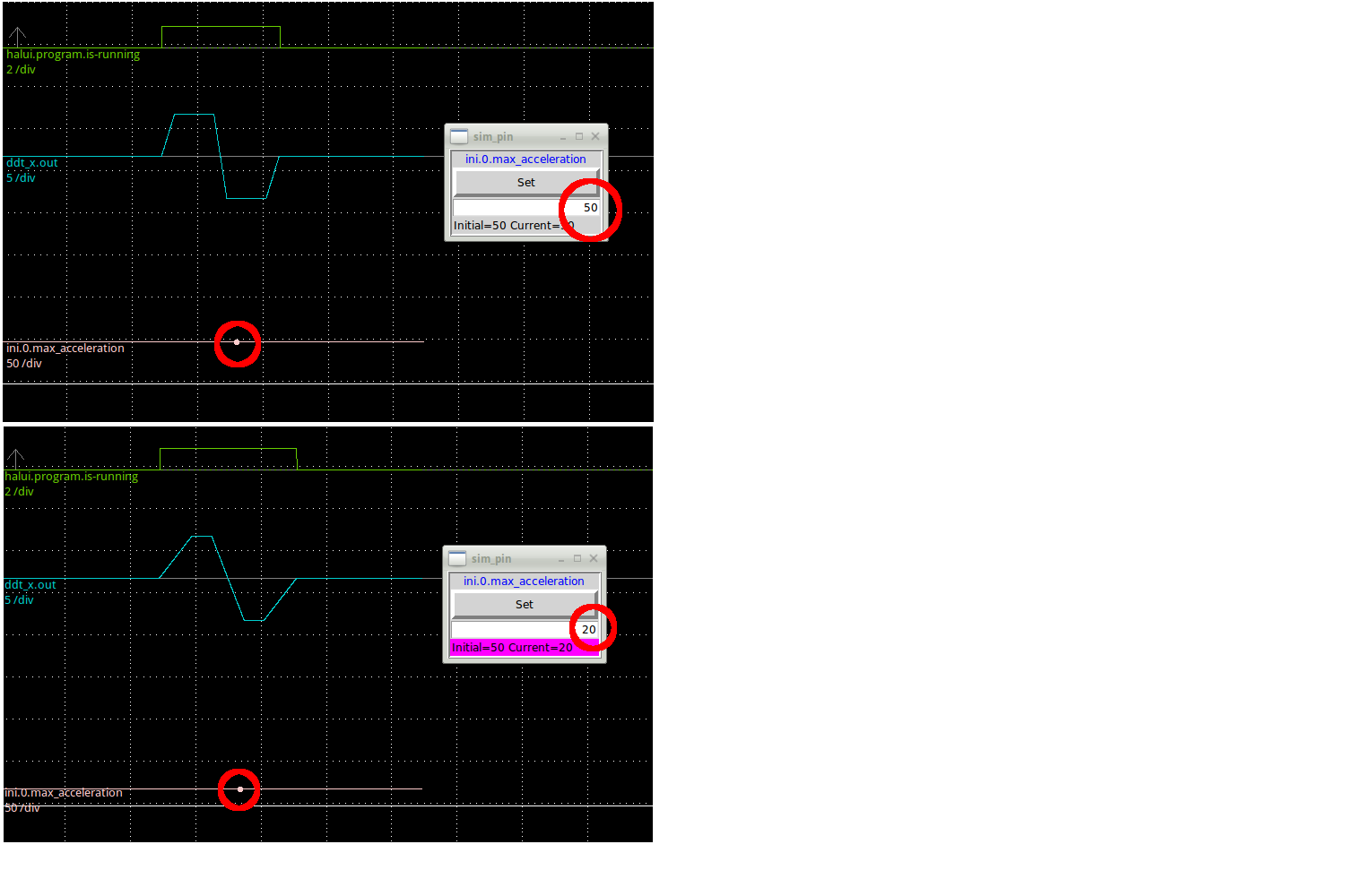

28 Sep 2014 06:19 - 28 Sep 2014 06:25 #51620
by dgarrett
Replied by dgarrett on topic PID tuning and accelereation
In linuxcnc2.6, hal pins are provided for a number of ini parameters
Example:
The linuxcnc script named sim_pin is useful for modifying hal pins like these during testing.
Example:
linuxcnc2.6 includes a simulator configuration that demonstrates the ini hal pins as:
This sim config starts up a sim_pin instance for a number of ini pins to demonstrate usage.
Example:
$ halcmd show pin ini
Component Pins:
Owner Type Dir Value Name
48 float IN 0.001 ini.0.backlash
48 float IN 0.05 ini.0.ferror
48 float IN 100 ini.0.max_acceleration
48 float IN 400 ini.0.max_limit
48 float IN 40 ini.0.max_velocity
48 float IN 0.01 ini.0.min_ferror
48 float IN 0 ini.8.min_limit
48 float IN 1e+99 ini.traj_default_acceleration
48 float IN 1.2 ini.traj_default_velocity
48 float IN 1e+99 ini.traj_max_acceleration
48 float IN 1.2345 ini.traj_max_velocity
Example:
$ sim_pin ini.0.max_acceleration ini.1.max_acceleration
configs/sim/axis/ini_hal_demo.ini
Last edit: 28 Sep 2014 06:25 by dgarrett. Reason: typos

29 Sep 2014 19:10 #51653
I appear to be completely out of date and a peddler of bad advice.
Does the tuning tool know how to tweak those?
Example:$ halcmd show pin ini Component Pins: Owner Type Dir Value Name 48 float IN 0.001 ini.0.backlash 48 float IN 0.05 ini.0.ferror 48 float IN 100 ini.0.max_acceleration 48 float IN 400 ini.0.max_limit 48 float IN 40 ini.0.max_velocity 48 float IN 0.01 ini.0.min_ferror

In my 2.7.0~pre from yesterday: no.
But that doesn't matter since executing a 'halcmd setp ini.0.max_acceleration 5000' does not give you the desired effect of setting acceleration. These values are cached somewhere in LinuxCNC; I saw some discussion about that in another topic.

works for me
change ini.0.max_accelration (while stopped)
The image shows velocity with ini.0.max_acceleration set to 50 and then 20 (inch units)
