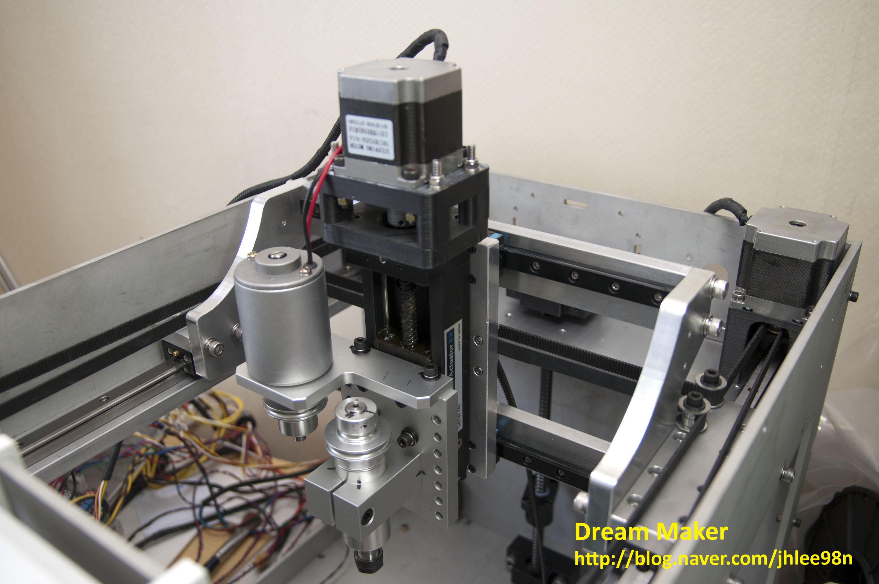

Since 2 years ago, I have made my Micro-CNC adopted H-bot(CoreXY) system. Actually, my machine was built for 3D printer. So its controller was Marlin firmware based on Arduino.
Because I wanted PCB milling and simple AL routing, I had changed my machine to CNC milling machine with H-bot system.
Then since 2 months ago, I have adopted my control system from Arduino to Linuxcnc, because Arduino based firmware has many leakages for CNC motion.

P/S: As reference, I attach my Micro-CNC and also in my blog page ( dreammakercnc.blogspot.kr/ ), you can see my Micro-CNC machine.

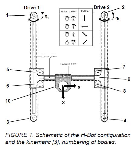

I understand H-bot has some complicated movement. In order to follow one axis stratly it needs to drive 2 motors simultaniouly.
For your understand, I attached H-bot's configuration and related documents.

Firstly, as I already menetioned, when set HOME_SEQUENCE = 1 for [AXIS_0] and [AXIS_1], Linuxcnc drived [AXIS_0] and {AXIS_1] motor simultaniously.
[AXIS_0] was moved foward to its MIN Limit and properly stop. But [AXIS_1] was moved to opposite direction (MAX position)
So, I modified to set HOME_SEARCH_VEL's value to negative in [AXIS_1] section in order to change [AXIS_1]'s Homing direction.
It was very successful.
[AXIS_1] always approached to its MIN Limit SW and then [AXIS_0] moved to its MIN Limit.
At that time, AXIS displayed "CG symbols" for All joints.
I think Linuxcnc obeyed the H-bot's kinematics during homing sequence because X and Y axis movement are properly achieved.
But AXIS displayed in correctly X and Y points during Homing sequence. i,e Linuxcnc drives each joint's motor by H-Bot kinematics but AXIS displays joint point simply.
( I'm not sure whether Forward Kinematics is applied rightly in AXIS display during home operaton.)
Any way, for the moment, I'm statisfied homing sequence setting because my machine finds its position and I can progress further work with my machine.
