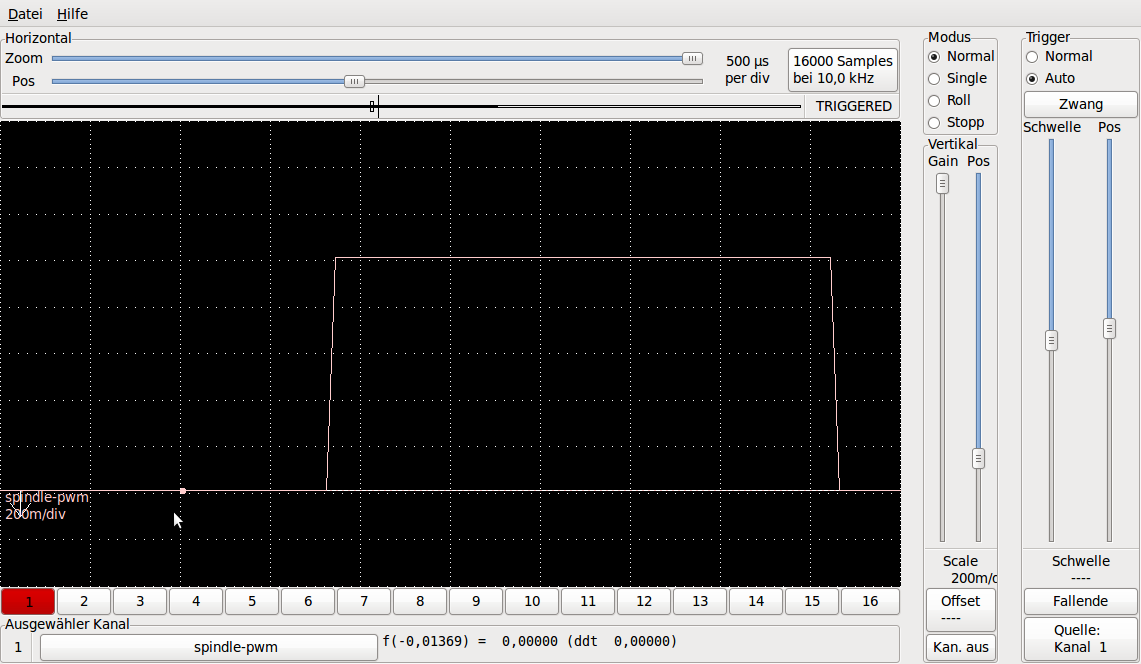

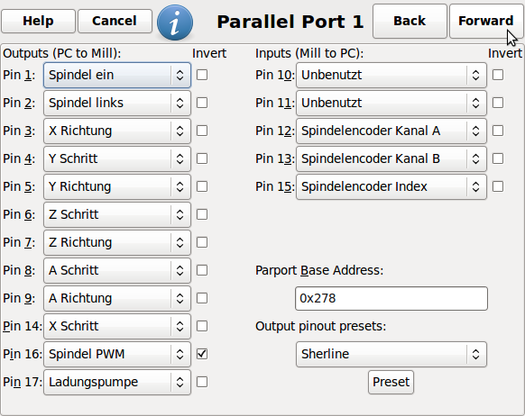

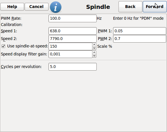

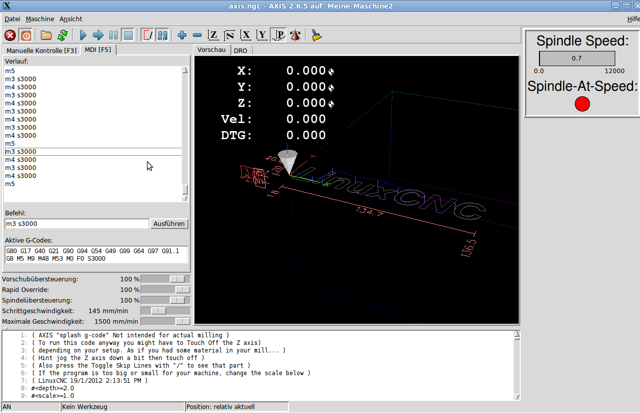

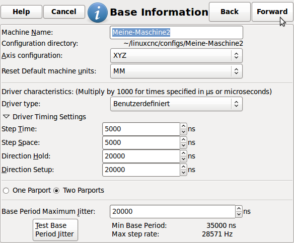

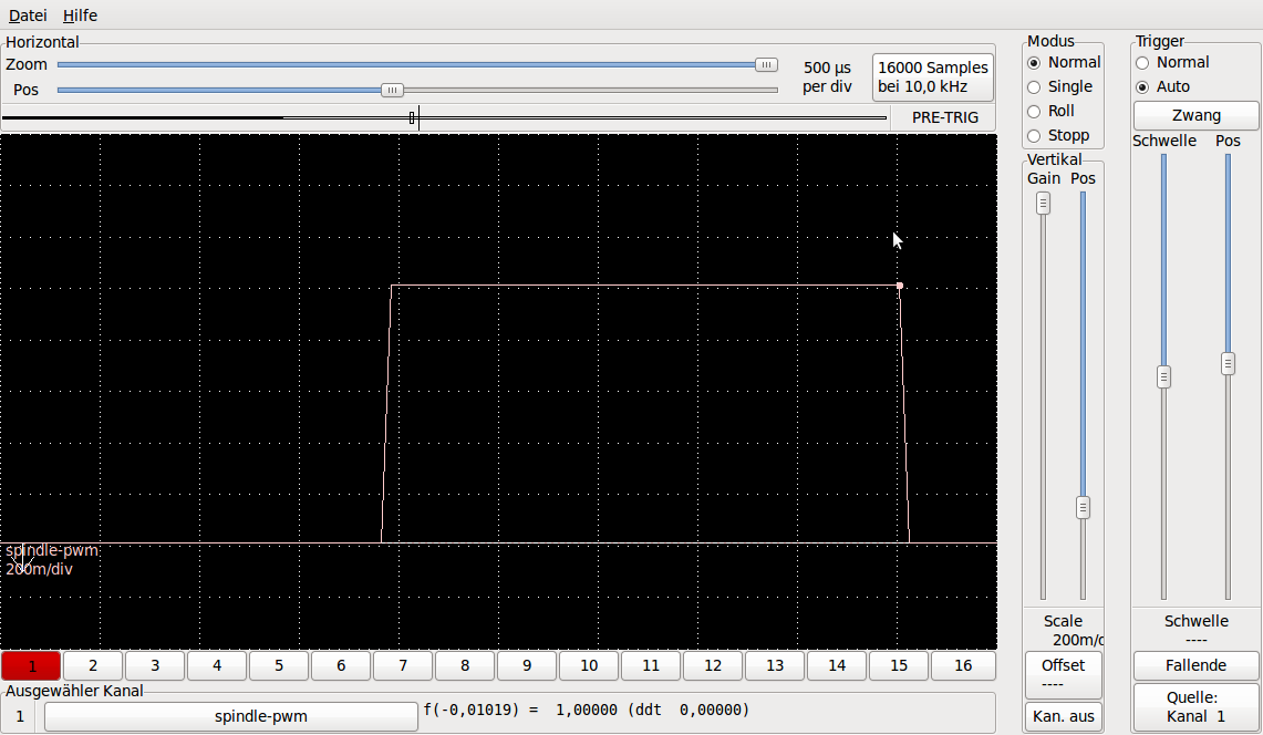

I set up my linuxcnc like in the pictures attached.
For this setup a worked with a Spindel attached with a FVD.
With commanded M3 S3000 (cw) it runs 2690 RPM.
With commanded M4 S3000 (ccw) it runs 2870 RPM.
So I checked the spindle-pwm signal with the HAL-Scope.
The pwm signal seems to be different with M3 / M4. (picture1+2)
Can somebody verify this on his own computer?

27 Dec 2014 00:21 #54310
Replied by PCW on topic LPT Spindel PWM Different Speed With M3 and M4
Not sure if the pwmgen offset does what you are expecting with signed PWM values
you may have to use the absolute function on the commanded spindle speed
and feed the pwmgen with only positive values (and get the dir signal from the abs comp)

27 Dec 2014 03:09 - 27 Dec 2014 03:32 #54311
by juergen-home
Replied by juergen-home on topic LPT Spindel PWM Different Speed With M3 and M4
So I changed the hal file the way to be told. Now it's working perfect.
Same speed for M3 and M4. Thank You.
