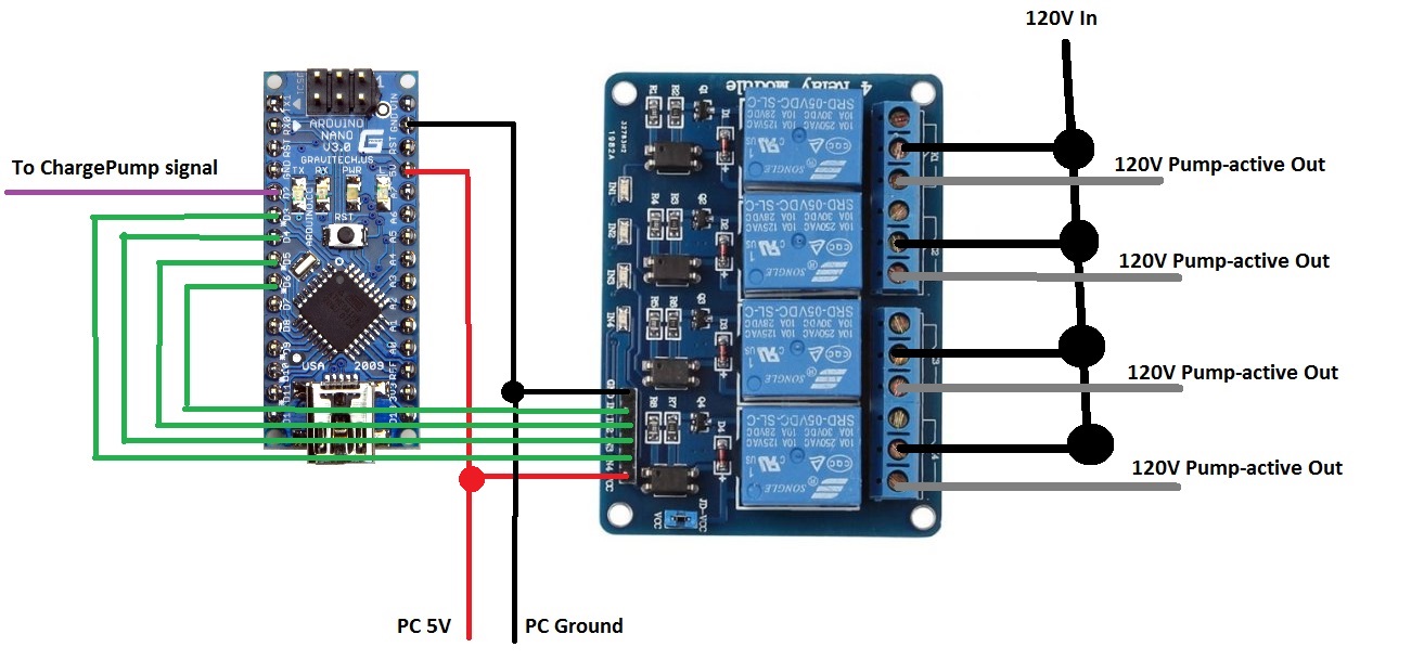

- TroyO
- Posts: 24
13 Feb 2015 01:38 - 13 Feb 2015 01:39 #55932
by TroyO
Replied by TroyO on topic Arduino for relay controls
Heh, on topic if not on-subject, I am using an Arduino Nano to control 4 relays as my chargepump/watchdog circuit.
If I stop getting a train of pulses from the PPort over 2k, it shuts down mains power to Spindle/Steppers/Coolant/Etc.
I know it's not exactly what is being discussed, but someone may find it interesting...I also am interested in the project using the arduino to gain some I/O since I already have one set up on my system anyway... I smell an opportunity to add more features, LOL. (Not that I actually can think of a USE for them yet.
Attached is a pic of the wiring.
Anyway, code below if anyone is interested.
