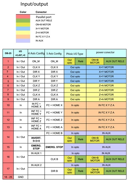

Hello to @ll.
I have 3 servopack Yaskawa SGDM-04ADA + SGMAH-04AAA21 servomotor.
Some body can tell me how to strat config it?
Stepconfig wizard or PnCConf Wizard , etc....
Many thanks in advance
Kindly regards.

- aer73
- Posts: 29
06 May 2015 13:21 - 06 May 2015 13:27 #58425
by aer73
Replied by aer73 on topic How start Config Yaskawa Servo
Last edit: 06 May 2015 13:27 by aer73.
- Posts: 23485
- Thank you received: 4994
06 May 2015 20:01 #58435
Replied by andypugh on topic How start Config Yaskawa Servo

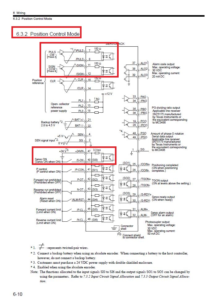

The interface card uses clk/dir to mean the same think as the
Yaskawa drive manual
calls pulse.
The Yaskawa drives do _not_ use pulse/dir, they use either CW/CCW pulses or quadrature pulses. LinuxCNC supports these pulse types too . Step type 1 is CW/CCW and step type 2 is quadrature. You need to configure the Yaskawa drives to work in this mode.
It seems that Stepconf does not understand step types other than step/dir so the open-loop tests won't work. Once you have created a config with pins allocated to step/dir you will need to manually edit the HAL file to change the step type to 1 or 2 to make the drives function. (only one line to change)

06 May 2015 20:45 #58437
Sure they do step/dir, page 8-48 of the manual you referenced, says that it is the default setting for position control.
Replied by Todd Zuercher on topic How start Config Yaskawa Servo
The interface card uses clk/dir to mean the same think as the Yaskawa drive manual calls pulse.
The Yaskawa drives do _not_ use pulse/dir, they use either CW/CCW pulses or quadrature pulses. LinuxCNC supports these pulse types too .)

06 May 2015 21:10 #58439
So it does. I only got as far as the table on page 4.4. And I mis-read that.
I have to say that running expensive Servopacks open-loop from a parallel port seems an odd choice.
The following user(s) said Thank You: aer73

- Posts: 23485
07 May 2015 00:07 #58446
The drive appears to have opto-isolated inputs, do you know if your break-out board has opto-isolated outputs?
You might need to wire things in a slightly unexpected way.
