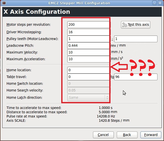

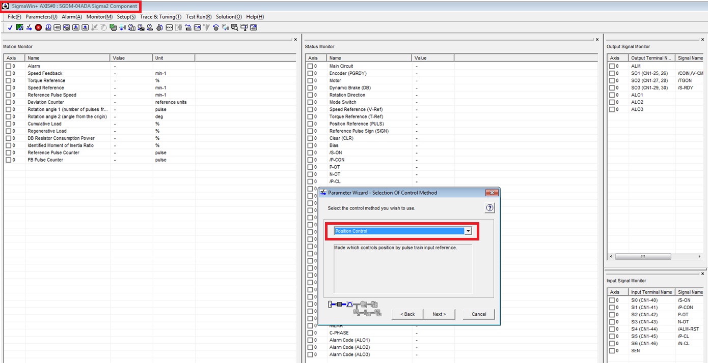

Yes i have conigured my Drives position Mode parameters with Sigmawin+.

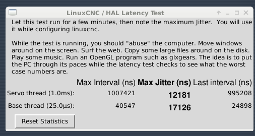

I start configuring Linuxcnc , have my latency test result but now don´t know where to find the necesary values for continue with config Linuxcnc.
I must learn more about it. Many thanks again for your help.
Kindly regards.

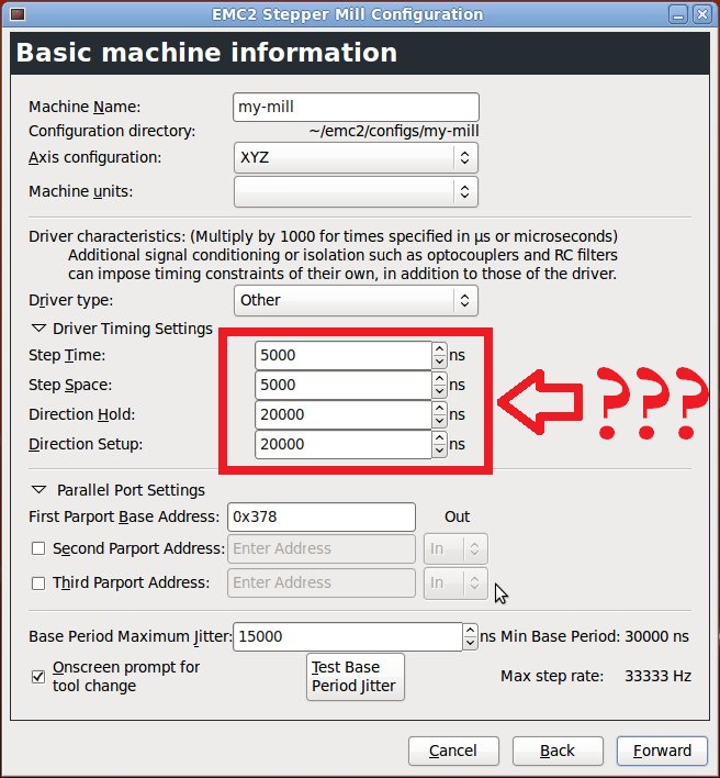

Please see this for timing ( Table 8.1 Reference Pulse Input Signal Timing, page 471 ), Reference Pulse Signal Form.
Look at the first part of the table where ( τ ≥ 1.0 μs). Your set-up shows 5000ns or 5us. This should be OK. Direction hold shows 20000ns or 20us. t(tau) is >= 1us. You could reduce this (20000ns) to say 5us. But do not reduce it below 1us.
Set your motor steps to your encoder count x4. Set micro-stepping to 1. Are you using incremental or absolute encoders?
I built my own DC servo drives and learned a lot about tuning. Sometimes trial and error can be the best for tuning. When you start tuning keep a dedicated log on the values you use. Also listen to how the motors sound. When properly tuned there will be no, or little audible sound, and or vibration from the servo motors.
If possible test a motor that is not connected to a machine. The other parameters can be determined from your machine setup, lead-screw etc.
Hope this helps,
Iron-Man
