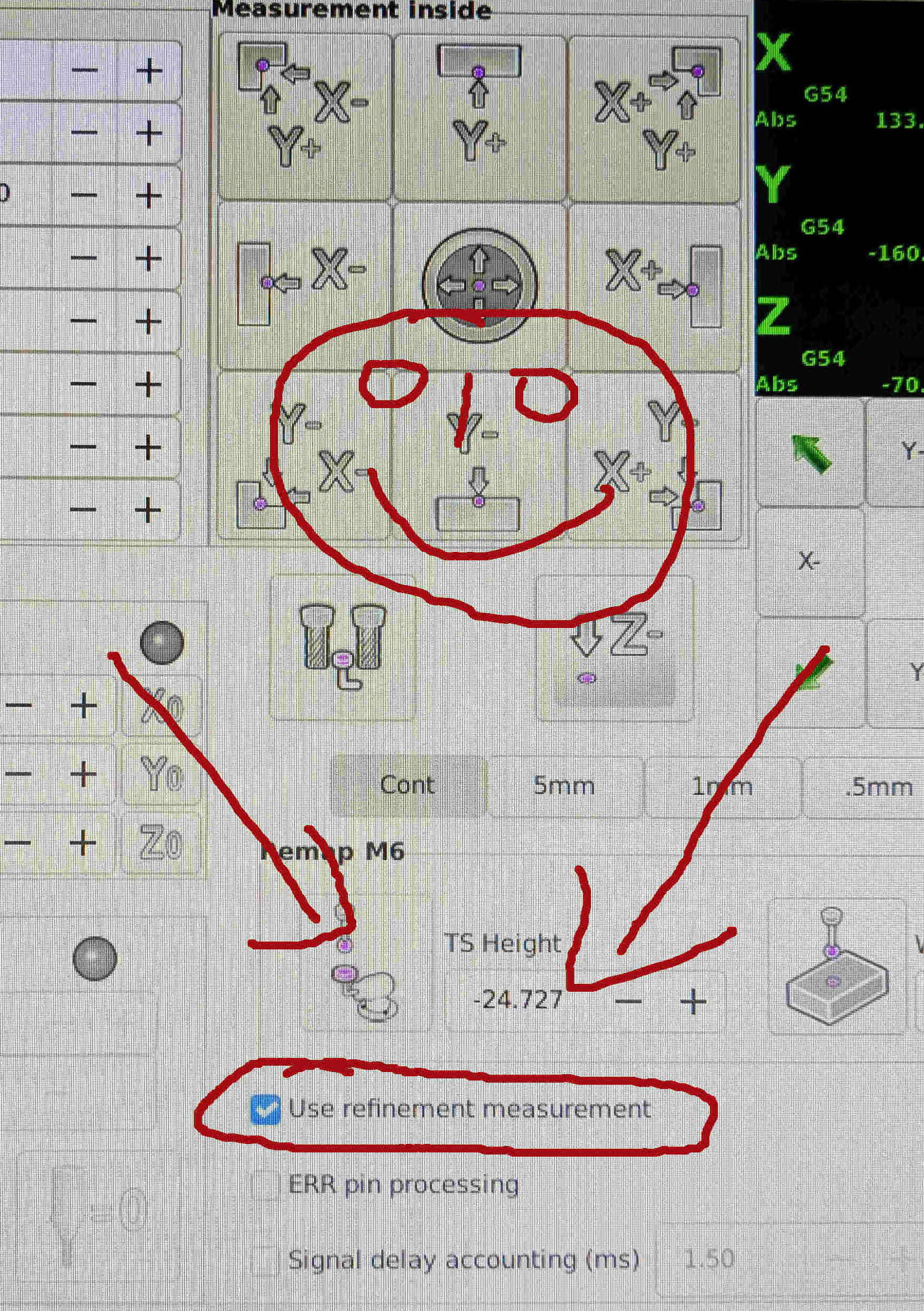

I have a minor problem with the probe screen 2.9, and your help would be greatly appreciated.
I have got the probe screen working fine, however I have this strange bug, that the Latching functionality is not working. What I mean by that is the measurement only happens in the search mode, and the following probing at lower speed is not happening. The measurement is taken during the first approach at Search speed. The same happens with the tool offset measurement.
While I was trying to debug this, I noticed that when I increase the Latch distance to, let's say, 10mm (5mm further than the XY Clearance), the probe will move to that location after the detection at Search speed, but then it will go back to the XY Clearance position at Search speed and then complete the measurement without doing the probing at Probing speed.
I am hoping it is some silly setting I forgot to enable somewhere deep in the config file.
Please help
Daz
Please help

Thanks for this. I have added the debounce function but it didn't didn't fix the problem. I am going to keep it as it looks like a good practice.
I don't have the settings you have in the ini file. However, the probe screen I am using has a separate file, "probe_screen.pref", where it keeps the preferences. Nothing seems to be missing.
I have checked the input signal in Halshow, and I can see the signal is going ON on the first approach at search velocity, but I don't see a second signal at probing velocity. The program just concludes the measurement and uses the value from the search velocity.
I am starting to think it is some kind of bug in a macro, but if that is the case, I am sure others would experience it as well.
I am using the probe screen v2.9 from this git repository:
github.com/verser-git/probe_screen_v2.9
Here are my settings for the probe screen and a macro to measure X- position (I hope it is the correct one). Perhaps someone can spot what is wrong:

Found it! And at the end, it was a simple option to tick.
While I was analysing the macro, I came across this lovely if statement:
;Check for refinement measurement
O7 if [#<_hal[probe.chk_use_fine]> GT 0]
And after checking the screen, here it is: "Use refinement measurement". After checking the option, there is a second probing action at probing velocity. Problem solved!
